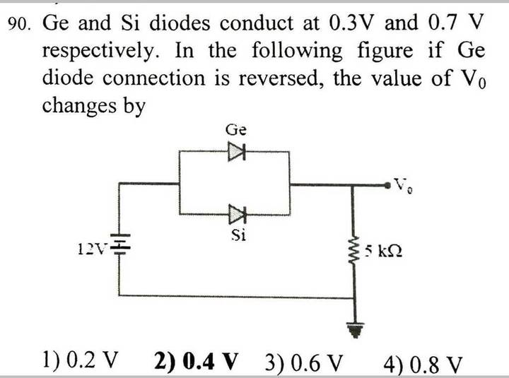

Two parallel diodes in a circuit
In summary, the conversation discusses the potential difference across two diodes in parallel and how it affects their conduction. It is determined that, assuming ideal components, the voltage across the diodes will never exceed 0.3V in the conducting direction. It is also mentioned that in circuit theory, there is no instant when there is no current through a circuit, and that components 'enforce' their v-i relationships across their terminals instantaneously. Additionally, there is a question about why we say the potential drop across a diode is 0.3V, and whether we can consider it as a battery with opposite polarity.

I am not quite sure how to deal with the two diodes in parallel . How do we know what is the potential applied across the two diodes so as to decide which one is conducting ?

As the voltage across the diodes rise, the Germanium will start to conduct first - essentially shorting out the Silicon.
So in the circuit shown, only the Germanium is conducting significant current.
With the Germanium reversed, it will not conduct at all. So the Silicon will conduct with a 0.7v voltage drop.

I have a very basic question .
Till the time the current is not flowing through any of the diodes , what is the potential difference across the two diodes ?
Is it 12 V ?
Assuming ideal components, you will never have 12V across the diodes in the conducting direction.
You will have, at most, 0.3V across the Germanium and, at most, 0.7V across the Silicon.
So when the Ge and Si diodes are in parallel and in the same direction as the circuit flow, the voltage across the (ideal) diodes will never exceed 0.3V.

Till the time none of the diodes is conducting , voltage across both of them will be 12 V but after germanium starts conducting voltage across it will be fixed at 0.3V .
After the current starts flowing , there will be a constant voltage drop of 11.7 V across the resistor and a constant voltage drop of 0.3 V across the germanium diode .
Is that correct ?

No, that violates circuit theory. That is not how voltages develop in a circuit.
In the original diagram where both the diodes are in forward connection, you have two probable scenarios:
1)Voltage across both the diodes is 0.7V, which means Vout=11.3V. So, I1=11.3/R
2)Voltage across both the diodes is 0.3V, which means Vout=11.7V. So, I2=11.7/R
In scenario 1), both the diodes conduct, so I1 should be more than I2 (almost double), but from scenario 2), it is clearly the opposite.
So which one do you think is the correct scenario?
Right.
That's what .Scott is saying in #4.

Would it be correct to say that a potential drop occurs across a diode after it starts conducting ? But if that is correct , then why do we say that potential drop across the Si diode is also 0.3 V ?

But you do agree that once the Ge diode starts conducting , the potential drop across the Si diode is also 0.3 V ?
If you do agree , then how is it that despite not conducting current through it , the drop across Si diode is 0.3 V ?
Because the Silicon diode is in parallel with the Germanium one. And silicon diode conducts when its voltage drop is 0.7V. Anything below that, it will act as an open switch.

If two components are in parallel they are connected between the same two nodes so must have same voltage.
One way to visualize how the circuit works is to replace the 12v with a 0-12v variable supply. Start it at 0V and gradually increase it.

I agree .
But by that logic , what is the voltage across the two diodes before anyone allows current to flow ?
If the input voltage is 0.2V (less than 0.3V), the diode voltage is also 0.2V and no diode will conduct. So, if you vary the input voltage from 0V to 0.3V, all of that voltage will appear across the diodes. I don't know if this is what you meant by "before any diode allows current to flow".

It's not clear what you mean by "before anyone allows current to flow"?
If you put a switch in series and open the switch the voltage across both diodes diodes will be zero.
If you replace the 12v source with a 0.2v source then that's not enough to turn on either diode so no current flows (using the model implied in the problem). If no current flows the voltage drop across the resistor is zero so the 0.2 v appears across the diodes.
At all times the drop across the ge is the same as the si. You can apply KVl to the little loop formed by the two diodes if you want.
Likes Jahnavi
Aside: If you use a different model for the diode you will get a different answer. The problem statement assumes a crude model where diodes don't conduct until a certain voltage across them. Real diodes actually have a IV curve so at 0.2v a small current may flow. If you want to know exactly how much current in this circuit you can plot IV curves for the source (power supply and diode) and the load (resistor) and where they cross will be the operating point. This is an example of solving two simultaneous equations by the graphical method which you may have covered in a maths class.

Why is the voltage drop across the diode a constant value , 0.3 V for Ge ? When a 12 V battery is applied across a Ge diode , the drop across it is a fixed value . Why ?
If you directly apply 12V across a Ge (or any) diode, the drop across it will be 12V and not fixed 0.3V.

Sorry .This is incorrect .
Voltage drop across a diode ( conducting ) is a constant value . 0.3 V for Ge .

No it's not (again, think of circuit theory). The Ge diode will draw an insanely high current at 12V and probably burn out.
That is just an approximation. It is called the constant voltage drop model.
Look up 'ideal diode equation' and you'll see that the v-i relationship of a real diode is exponential.

My earlier response was under the assumption that the 12 V battery placed across the diode is non ideal i.e it has some internal resistance .
Voltage drop across diaode will be 0.3 V , rest 11.7 V appears across the internal resistance .
I think you are assuming an ideal battery .

Yes, as they have used an ideal battery in your OP.
Using constant voltage drop model, yes.

Yes, at the instant the switch gets closed the initial current is zero, and 12 V appears might appear across the diodes, but the diodes and all the circuit do not behave as ideal ones. The p-n junctions of the diodes behave as capacitors and all wires behave as resistors and inductors. There will be some transient current in the circuit (till the equilibrium charge distribution builds up at the p-n junctions) which ends in the stationary voltage drop across the diodes and stationary current in the circuit in a very short time.
