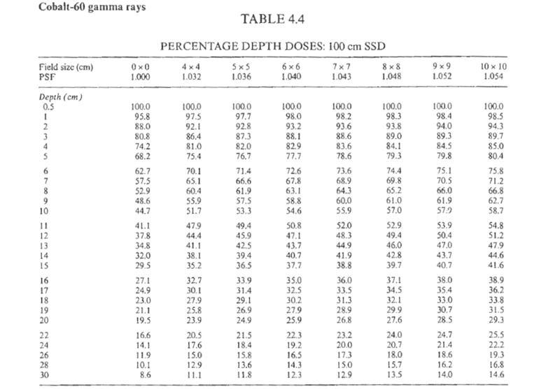

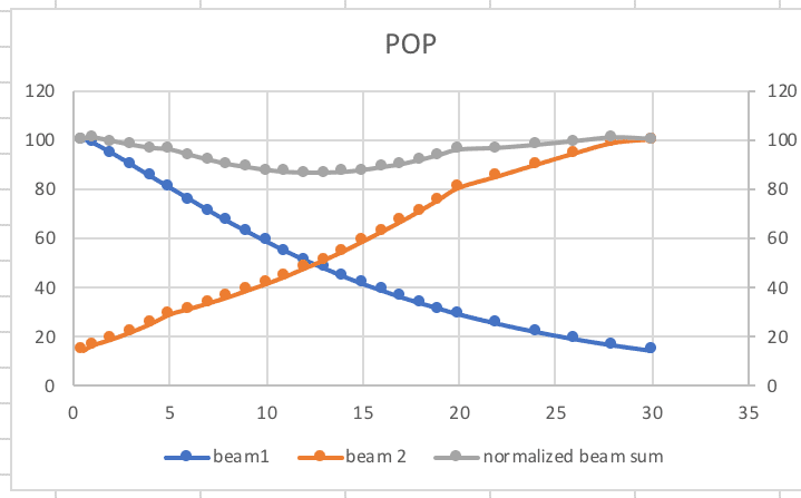

Hi everyone,
I have this question about POP.
Assume a patient separation of 20cm. Using data for 6MV , FS 10x10 cm, plot the depth dose for one beam at 2 cm intervals. Include on your plot the dose at dmax and the dose at 20-dmax.
On the same graph repeat this for the opposed beam. Now plot the sum of the depth doses on the same graph.
Renormalize this POP distribution to 100% at midplane.
data are attached.
I tried to solve it in excel but the but i got the graph little bit different than what our teacher told us :nb)
Please help.
Thanks.

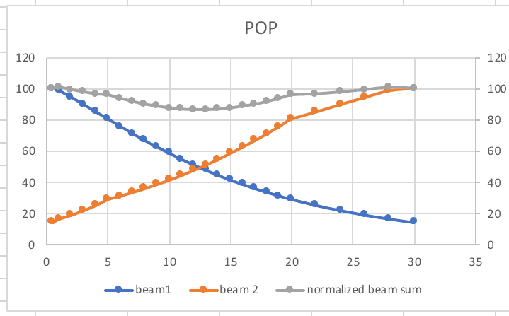

Beam 2 has an odd shape.
Independent of that: Why does it start with 100% relative dose at 30 cm?
Where did you use this?
I did not use that i only used the the data in the table, did not know how to use the separation:frown:
