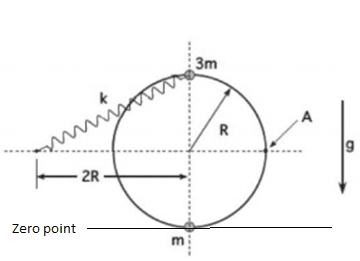

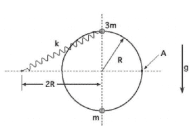

In this problem, I have two particles that slide on a ring with a radius of R. The ring is orientated in a vertical plane. One of the particle is heavier than the other and has a mass of 3m. The heavier particle is attached to a spring with an unstrectched length of 0 and a spring constant of k. The fixed end is attached at a distance of 2R from the center (see attached photo).
I need to work out the following:
1) The kinetic and potential energy of the heavy particle in the initial state, when it passes the left most position, horizontal with respect to the center of the circle, and when it hits the light particle.
2) The velocity of the heavy particle when it hits the light particle, and their joint velocity after their collision
3) What is the work done by gravity and the work done by the spring on the masses (mass=4m) from the release of the heavy particle until they both stop at point A in the figure?
Part 1)
At the highest point, the heavy particle has a kinetic energy of K = 0, since it is stated that the particle is at rest. The potential energy is different from 0, and it both has a gravitational potential energy (mgh) as well as an elastic/spring energy. The total potential energy for the heavy particle is given my U = U_k + U_h, where U_h is the potential energy due to gravity and U_k is the potential energy due to the spring.
I set my coordinate system, so the zero point is where m is on the figure, so I have the following:
U_h = mgh = 3∙m∙g∙2∙R = 6∙m∙g∙R
U_k = 1/2∙k ∙ x^2 = 1/2∙k ∙ 〖(√5R)〗^2 = 5/2∙k ∙ R= 5kR/2,
where x is the length of the spring and k is the elastic constant
The total potential energy for the heavy particle in its initial state is then:
U = U_k + U_h = (6∙m∙g∙R) + 5/2∙k ∙ R

Now that you have the top and left position, what about the bottom before the collision?
mfb said:
That looks better.
My zero point goes through m (the bottom of the ring), so the potential energy in the bottom of the ring must be 0.
There is not only the gravitational potential.

So the potential energy due to gravity must be 0, while the spring potential energy is different from zero. We have:
U_h (bottom) = mgh = 0
U_k (bottom) = 1/2 * k * x^2 = (5kR^2) / 2
I tried to solve the rest of the question. Now that I have found the potential energy at the bottom, I am going to calculate the velocity of the heavy particle when it hits the light particle, and their joint velocity after the collision. First we look at the velocity of the heavy particle:
I want to find an expression that links the potential energy at the bottom to the kinetic energy:
PE = U_h (bottom) + U_k (bottom) = KE = 1/2 * m * v^2
Inserting in the above equation, we have:
(5kR^2) / 2 = 1/2 * m * v^2
I solve the equation for v, and I get:
v = sqrt( (5*k*R^2) / m )
Which is the velocity of the heavy particle when it hits the light particle.
