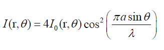

If intensity from each slit is I, then I have intensity of 2I after slits plane.
Interference is given by:
So at bright fringes I get cos^2=1, so intensity is 4I. And in dark fringes I get cos^2=0, so intensity is 0.
Since interference just distributes the intensity over screen, the cos^2 pattern with 4I maximum and 0 minimum, on average, results in a 2I intensity, as just after the slits plane.

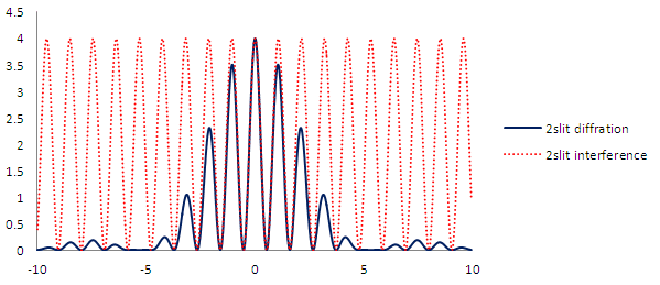

Now I add the diffraction, i.e. multiply by sinc^2. This leads to a lower intensity pattern compared to the case of pure interference, so averaged intensity will be lower then 2I. Where the energy is lost?

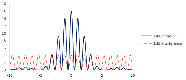

Still didn't get it. I understand that this must be true (energy is conserved) and even understand why it's true (intuitive) for the interference case. But when the diffraction is introduced, I cannot get it in intuitive way. The only explanation I can think of is that I don't multiply by sinc^2 in the diffraction case, but rather by Asinc^2, where A is some normalization constant which ensures energy conservation. So the overall picture will look like that:
And not like that:
