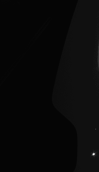

Hello everyone. I have a question about Optics and I place here because I don't know if there are a specific thread.
I am using a laser beam to calibrate position of several cameras. But instead of to have one spot in the image I have two spot. One of them is smaller of the other.
I presume that the smaller one is some kind of reflection, maybe in the material, maybe in the optics of camera.
The focal length of camera optics is 9mmm and resolution is 1600 pixels.
Have someone any idea of the cause of this reflection?
Have someone eperienced something similar?
Thanks a lot in advance!

The laser is pointing to a painted metal surface and in parallel to laser and similar distance is located the camera. The resulting image of the camera have two laser spot. one es very big. The other spot is close to the first one and much smaller.

Do you see two spots with your naked eye too, or just in the camera image? It's probably just internal reflection inside your camera optics...

That is the image. I need only the main spot of the laser but there are a secondary reflection...
Do you have any pictures with the lights on? :smile:
No. That is illumination that we are using. We only need the laser spot so only use environment lighting.
Move the camera up and down and check if the distance between spots changes in the image. If there is some reflection from camera optics, the smaller (reflected spot) should jiggle randomly and disappear when your main laser beam hits the lens on optical axis. If you distance is almost constant and smaller spot does not jiggle, then it means the second spot is not caused by the camera :)

I don't think it is this since any reflection from the back of the paint would be diffuse and the second spot you're seeing is sharp. I agree that it's most likely ghosting flare in the camera lens. A coated lens will usually eliminate such artifacts unless the light source is very bright, as is the case here.
Likes Fernando
My guess is that it is a reflection between surfaces in the compound lens.
