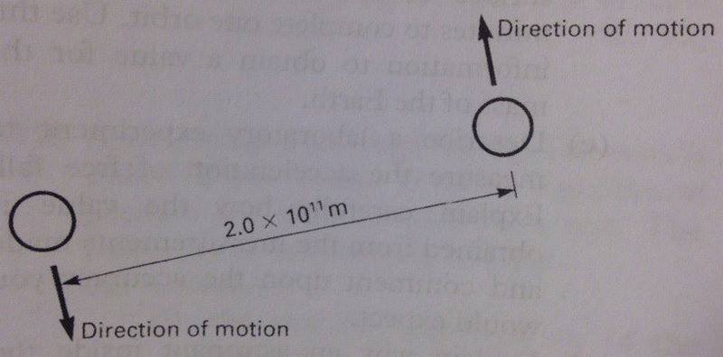

The diagram shows a binary star system consisting of two stars each of mass 4 * 1030 kg separated by 2 * 1011 m. The stars rotate about the centre of mass of the system.
(a) (i) Copy the diagram and, on your diagram, label with a letter L a point where the gravitational field strength is zero. Explain why you have chosen this point.
(a) (ii) Determine the gravitational potential at L. (G = 6.7 * 10-11 N m2 kg-2.)
(b) (i) Calculate the force on each star due to the other.
(b) (ii) Calculate the linear speed of each star in the system.
(b) (iii) Determine the period of rotation.
Answers: (a) (ii) -5.36 * 109 J kg-1, (b) (i) 2.68 * 1028 N, (ii) 2.59 * 104 m s-1, (iii) 2.43 * 107 s
2. The attempt at a solution
(a) (i) L should be the middle point between these two stars since the point where gravitational field strength is zero is the point where two gravitational fields cancel out.
(a) (ii) Using the formula: U = - Gm / r = - 6.7 * 10-11 * (4 * 1030 + 4 * 1030) / [(2 * 1011) / 2] = - 5 360 000 000 J kg-1.
(b) (i) F = Gm1m2 / r2 = (6.7 * 10-11 * 4 * 1030 * 4 * 1030) / (2 * 1011)2 = 2.68 * 1028 N.
(b) (ii) v = √Gm1 / 2 / r = √(6.7 * 10-11 * 4 * 1030) / (2 * 1011) / 2) = 51 768.7 m s-1. Doesn't fit the answer, though if we divide this by 2 we get 25 884 m s-1, same as the answer.
(b) (iii) T = 2πr / v = (2 π ((2 * 1011) / 2) / (2.59 * 104) = 24 259 403 s.
Is my logic in (a) (i) correct? What's wrong with (b) (ii)? Other calculations should be right, but if not, what did I miss?
(a) is correct. Please explain your logic in (b), otherwise it is difficult to see exactly why you get a factor of 2 wrong.

This only accounts for a factor sqrt(2) (the reduced mass of the system is half of the individual masses). He has also used the distance from the center of mass instead of the separation distance.
The reason I wanted him to state his reasoning was to make him think about theprerequisites of the formula rather than just inserting numbers without thinking first.

v is velocity, G is the gravitational constant, m is the mass of one star and r is the radius of the star from the star to the point L.
gneill said:
For (b) (ii), the gravitational parameter (##\mu##) for the system depends upon both masses. You need to use right value for ##\mu## if you want to apply the equation ##v = \sqrt{\frac{\mu}{r}}## . You can check this yourself by equating the gravitational force to the centripetal force for one of the masses, solving for v.
If I understood you correctly, it should be not m1 / 2 but (m1 + m2) or (m1 * m2)? In both cases the answer is wrong (73 212 m s-1 and 1.04 * 1020 m s-1).

Update: F = ma → a = F / m = 2.68*1028 / 4*1030 = 0.0067 m s-2 → a = v2 r → v = √ar = √0.0067 * 1011 = 25 884 m s-1. Looks correct.
moenste said:
That particular formula is based on a satellite of mass m orbiting the Earth with speed v along a circular path of radius r. F = mv2 / r = GmmEarth / r2. But looks like this formula is of no use to this situation.
Don't just try to apply a formula blindly. Go back to basics. You have a diagram of your situation; Identify the distance that must be used to find the gravitational force. Identify the radius of rotation that must be used to find the centripetal force on one of the stars. Note that the two distances may not be the same!

But in our case we have two stars of the same mass. v = √G(m/2) / r = √(6.7 * 10-11 * (4*1030)/2)) / (2 * 1011) = 25 884 m s-1. But the situation is not "one body is overwhelmingly more massive than the other".
I think it's easier to derive the answer with F = ma → a = F / m = 2.68*1028 / 4*1030 = 0.0067 m s-2 → a = v2 r → v = √ar = √0.0067 * 1011 = 25 884 m s-1.
Likes drvrm
The point is that you can reduce the two body problem to a mathematically equivalent situation - but you need to take care about what the effective mass and potential are.
Of course, both approaches give the same result and I would use the force approach if teaching at basic level.
