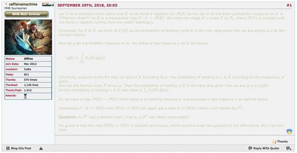

Congratulations. You have managed to color your post unreadable.
I am not sure what is wrong. It's appearing on my computer just fine.
Perhaps you are viewing it on another device?
When I quote-reply your original post, I find that each paragraph is inside a set of color-tags with color code #cbd2ac. When I remove those tags, the text becomes readable.
Screenshot shows what I'm getting.
