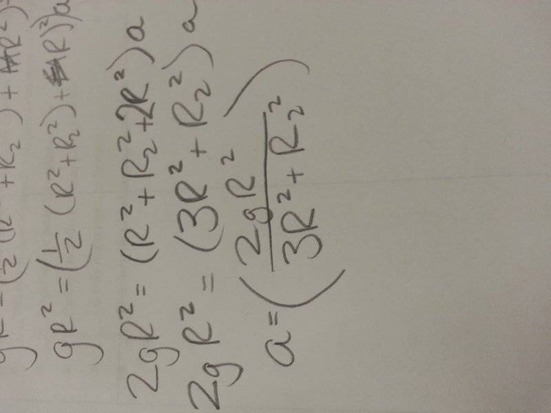

Hate to bump this up again, but I've gotten pretty far but got jumbled on one part.
So I did net torque = I(alpha)
And did some substitution
mg*R = (((1/2)(M) (R^2+R2^2) + MR^2))) (a/R)
Thing is, would
R^2+R2^2 be the same as the other R's?
Sorry if I'm not being clear. But how would the formula play out? I know M cancels.
This looks good. Note: R is the outer radius; R2 is the inner radius.

Thanks for all your help, and I think I got it.
After a bit of Algebra:
(2/3)((g*R^2)/(R^2+R2^2))=a
And the other a=g
Is that all I can do?
And then compare it?
I get something slightly different, so double check your algebra.
And the other a=g
Once you have the two accelerations, figure out how the heights they must be dropped from have to relate for them to fall in the same time. (Hint: for a given distance, solve for the time to reach the ground.)
Oh,
So I did a bit.
Is this correct?
I brought the R from a/R to the other side.
I wanted to cancel the 1/2 so I multiplied everything by 2.
2gR^2 = (R^2+R2^2+2R^2) a?
Oh I see my mistake! So this is right?
Oh,
So I did a bit.
Is this correct?
This looks better. But simplify the expression within the parenthesis a bit--combine terms.
Looks good.
