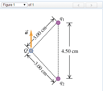

Two point charges q1 and q2 are held in place 4.50 cm apart. Another point charge -2.00μC of mass 6.00g is initially located 3.00 cm from each of these charges and released from rest. You observe that the initial acceleration of -2.00μC is 354m/s^2 upward, parallel to the line connecting the two point charges. Find q1 and q2.

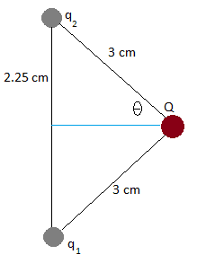

Okay so here is what I did. I already knew what Q1y was (1.062), so I found the angle created by q1x and q1. To do this:
## tan\theta\\ = 0.0225/0.03 => arctan(0.0225/0.03) = 37 ##
So now that I know what the angle is, I can solve the smaller triangle created by q1, q1x, and q1y.
## sin\theta\ = q1y/q1 => q1 = q1y/sin\theta\ => 1.062/0.6 = 1.77 = q1 ##
I don't believe the tangent function is correct here. See diagram below.
Your notation is kind of dangerous. By q1 and q1y here, I guess you mean the forces Fq1Q and Fq1Q,y.

OK, but Q is not 2 Coulombs.

I attached a picture of the system, this was provided by the website. I should have included that with the initial post, I didn't think it could be interpreted in the other direction.

I think I got it this time...

Ohh I see what you're saying. It shouldn't be tangent at all, I should be using opposite over hypotenuse. So sine instead.
The FQq1 comes out to 1.42 N, so plugging that into solve for q1 I get 7.11x10-8.
That was the correct answer. Thanks a lot for the help, I appreciate it!
