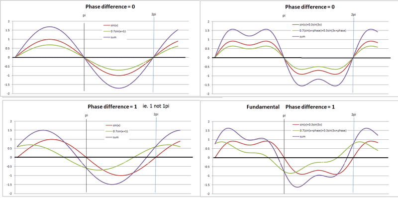

May I know how is it possible for two waves to be in phase when they have different amplitude? I couldn't find any existing graphs that clearly shows how the two waves are in phase, would anyone be able to sketch it out so I can have a look. Thank you:smile:
Welcome to PF.
Phase refers only to the time axis.
If you plot Sin(x) and 1+2*Sin(x) the waves will still be in phase, but one will be scaled and shifted vertically.
Likes russ_watters, jbriggs444, hutchphd and 2 others
OHH therefore the nodes of both waves will still be on the same spot, but the wave will be stretched vertically! Thank you

I'm not sure what you mean by waves, nor, for that matter, phase! However, here are
-two sine waves, one with an amplitude 0.7 of the other
-two sine waves, one with an amplitude 0.7 of the other and time shifted by 1 cycle/ 2pi
- a composite wave comprising a fundamental and a third harmonic with an amplitude of 0.3 of the fundamental
- a composite wave with 0.7 times the amplitude of the above and both fundamental and third harmonic time shifted by 1 cycle/2pi
If two waves have the same amplitude at all times, they are not just in phase, but are identical.
If two sinewaves are in phase, I can't see where amplitude has any bearing on it.
Maybe two waves of different frequency are sometimes said to be in phase when their combined envelope has a greater amplitude than either wave, or out of phase when the sum is less than either, but I think it is not well defined.

thank you so much it helped me understood a lot!
Likes davenn
Glad it helped. I always like diagrams and pictures to help me understand.
