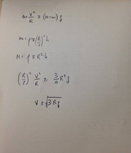

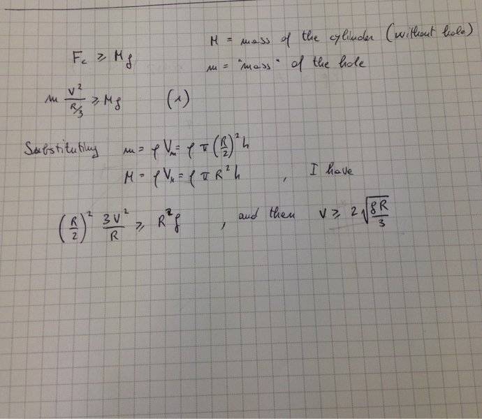

Ok I'm sorry. My work is this
No, I'm wrong. Instead of M I have to put ##(M-m)##. So the final equation becomes ##\frac{R^2}{4} \frac{3v^2}{R} \geq \frac{3}{4} R^2 g##
And I think that the radius for the centripetal force I'm taking is wrong.
fedecolo said:
Ok I'm sorry. My work is thisView attachment 204213
Is that v the speed of the system or the instantaneous speed of the centre of a hole?
I assumed v as the speed of the system.
I would like to add a comment which does not have direct relation to the problem under consideration but it seems that it would also be useful here. For simplicity assume that a rigid body rotates about a fixed axis with constant angular velocity. What can one say about centrifugal forces relative to a body fixed frame? Very common wrong answer is as follows: the centrifugal force is applied to the center of mass.
I can state that here the centre of rotation is not the centre of mass. Is it possible to use this fact to get the solution?
But in your centripetal force calculation you seem to have taken it as the tangential speed of the centre of the hole relative to the system.
Ok, but also as well is wrong[emoji24]
fedecolo said:
Ok, but also as well is wrong[emoji24]View attachment 204260
If v is the velocity of the system, what is the tangential velocity of the centre of the hole relative to the system?
What is the radius of rotation of the centre of the hole?
Get those two things right at the same time and you will be there.

Maybe I got it: because ##\omega## is constant, ##v_{hole}=\frac{v}{3}##, then the radius of rotation is R/3, so I have that ##\frac{R^2}{4} \frac{\frac{v^2}{9}}{\frac{R}{3}} \geq \frac{3}{4} R^2 g## that gives the solution. Thank you all!
That's it.
But there is a subtlety in that which might have you tripped you up, and is worth being aware of.
The velocity of the hole, v/3, you (correctly) used is its tangential velocity relative to the centre of the solid cylinder, not relative to the ground. Just wanted to make sure you realized that.

Yes because the tangential velocity of a homogeneous wheel is 0 at its lowest point (in contact with the ground), isn't it? Is it the same for a wheel with an hole?
No, I think you are missing the point.
The cylinder wil start to jump when the hole is at its lowest. At that position, the hole's centre is moving backwards at v/3 relative to the system, so its velocity relative to the ground is 2v/3 forwards. But its centre of rotation is moving forward with the system, so for the centripetal force calculation it is the relative velocity of v/3 that must be used.
