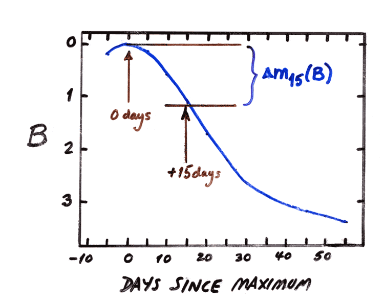

So are you saying the variation in Absolute Magnitude is already accounted for in the Phillips relationship?
originally defined as the decline in the B-magnitude light curve from maximum light to the magnitude 15 days after B-maximum, a parameter he called
. The relation states that the maximum intrinsic B-band magnitude is given by [5]

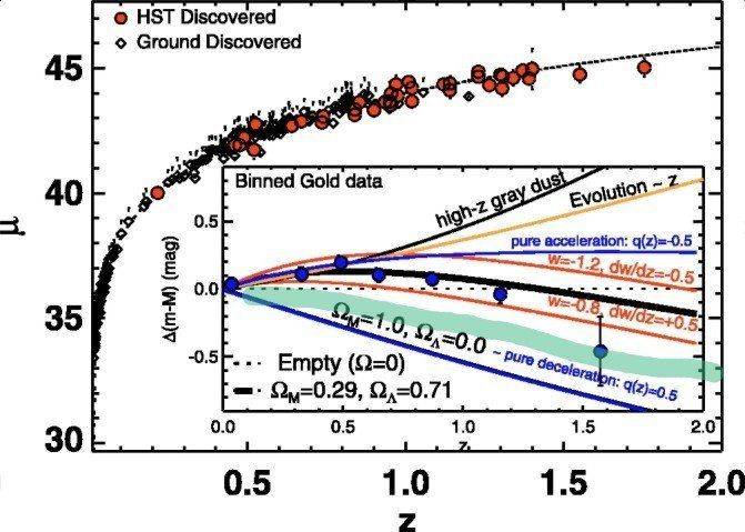

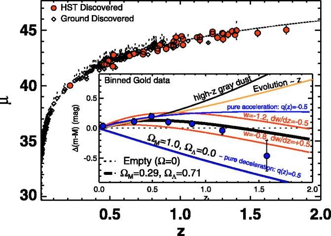

To see the problem I post the SNe ia Hubble diagram taken from New Hubble Space Telescope Discoveries of Type Ia Supernovae at z ≥ 1: Narrowing Constraints on the Early Behavior of Dark Energy (Reiss et al 2007)
MLCS2k2 SN Ia Hubble diagram. SNe Ia from ground-based discoveries in the gold sample are shown as diamonds, HST-discovered SNe Ia are shown as filled symbols. Overplotted is the best fit for a flat cosmology:
M = 0.27,
= 0.73. Inset: Residual Hubble diagram and models after subtracting empty universe model. The gold sample is binned in equal spans of n
z = 6 where n is the number of SNe in a bin and
z is the redshift range of the bin.
