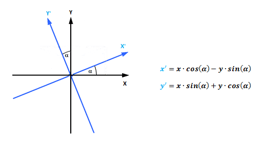

My question is the following: It's well-known the relationship between two pair of cartesian axes when a circular rotation is made:

A relationship similar to the equations above?
Sure. Just use trigonometry: find vectors that correspond to the new axes (x', y') expressed in the old coordinate system (x and y), then find a way to express an arbitrary point on the plane (given in the old coordinates) in the new coordinates. It is a linear equation system.
Alternatively, start with a point given in the new system and transform back to the old one. That gives the same equations but written in a different way.

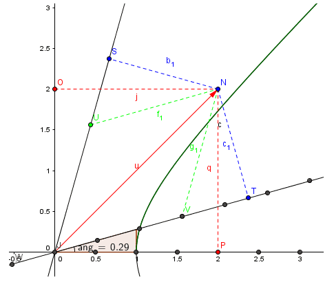

Thank you for your replies! My question now is related to the previous one, but has changed. Suppossing that we have the following situation:
According to the picture, we have a vector in an orthogonal frame (with coordinates 2, 2). I want to obtain the contravariant (green) and covariant (blue) components in a new frame where the axes have been rotated an hyperbolic angle alpha.
I have checked that the contravariant components can be obtained as follows:
\begin{bmatrix}{a^1}\\{a^2}\end{bmatrix}=\begin{bmatrix}{cosh(\alpha)}&{-sinh(\alpha)}\\{-sinh(\alpha)}&{cosh(\alpha)}\end{bmatrix}\begin{bmatrix}{a_x}}\\{a_y}\end{bmatrix}
My question is, which is the expression to obtain the covariant components? Maybe I should use the inverse matrix?
\begin{bmatrix}{a_1}\\{a_2}\end{bmatrix}=\begin{bmatrix}{cosh(\alpha)}&{sinh(\alpha)}\\{sinh(\alpha)}&{cosh(\alpha)}\end{bmatrix}\begin{bmatrix}{a_x}\\{a_y}\end{bmatrix}
Thanks for your help.
