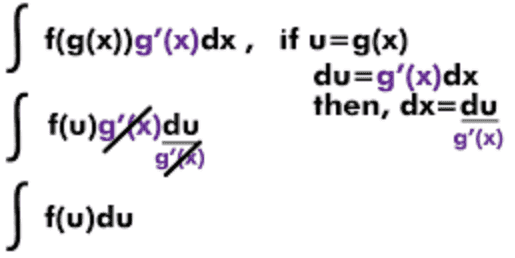

I've been warned by a professor to not do u-substitution like this unless du is a constant (ex: a number, like du = 4 dx).
But, if g'(x) is a variable like x^2, I shouldn't use division like this due to division by zero issues?
I know that du can directly replace g'(x)dx in many cases.
But, is division really wrong here?
Any book references on this?
See image.
It is disturbingly correct, i.e. usually works. But if ##g'(x)=0## then you have divided by ##0## so you have to be careful. The infinitesimals ##dx,du## are not numbers, so they cannot be treated as such. They abbreviate limits. However, it works.
It is a reminder to check afterwards: Solve the integral and differentiate the result in order to check whether you end up where you started from.

It makes intuitive sense to me.
But, if g'(x) = 0, then the original g(x) within f(x) would be a constant, which would make f(x) a constant. This, in turn, would change our entire approach to the integral and perhaps even obviate u-substitution.

I haven't checked all possibilities, so I was cautious in my answer. What we are doing is a kind of coordinate transformation: instead of walking the integration path along ##x##, we walk along ##g(x)##. This shouldn't change anything if ##g(x)## is one-to-one, but needs special care if not, e.g. splitting the integral.
The integration limits change, too, so that is also important to consider.

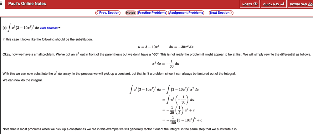

As a conclusion, I think this is the best way for a student to proceed/process u-substitution:
Manage constants by "division" / "adjustment" BUT directly replace all other variables.

It seems fine to me. If ##F(u)## is an antiderivative for ##f(u)##, then ##F(g(x))## is an antidervative for ##f(g(x))g'(x)## by the chain rule. I think this is all the statement is saying.

The professor wants what Paul's Online Notes shows.
Directly substitute all variables and differential symbols ("dx" and "du").
Constants, you can divide.
I have come to agree with his method.
The division thing, except in the case of a constant, seems to be a mathematical coincident/fluke?
