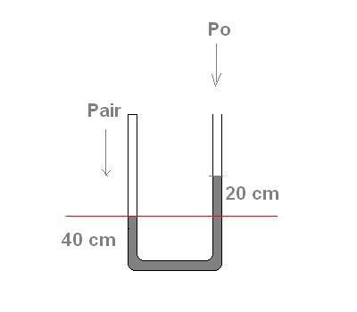

The 40 cm column in the left tube is below the air column, it does not add to the pressure. See attachment. The downward force at the red level has to be equal in both tubes, so the air pressure in the left tube is equal to the atmospheric pressure+ the pressure of the 20 cm mercury column.
Very clear explanation. Got it, thank you!
