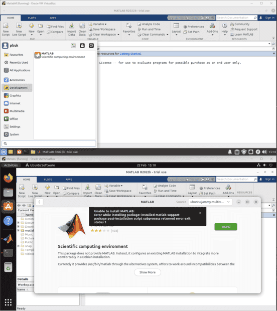

I want to try understanding which is the best setup for a Linux OS in dual boot with Windows on my laptop, having a small SSD.
I'm a Master student in Physics and my professor for the thesis suggested to use an OS different than Windows, so I want to install a Linux distro in dual boot since I don't want to completely leave Win10 at the moment. I shall point out that I will be working in condensed matter physics (DMRG) and install some codes in the new OS (Python with TeNPy, maybe Julia, plus some plotting library), along with a couple of useful apps like Matlab and so on.
On my laptop I have a 128gb SSD (Intel SSDSC2KF128G8L) with only 45gb of free space and a 1tb HDD (Seagate ST1000LM035-1RK172) with 350gb of free space (I can also remove more trash from the HDD, but not so easily from the SSD). So my idea was to create partition for the root in the SSD and the one for /home in the HDD, in order to still exploit the speed of the SSD. However, I'm not sure I have room in the SSD to leave both systems enough empty space in order to run efficiently, since I got contrasting opinion looking on the web. Therefore, I'm asking for any advice about the following doubts:
Should I use Ubuntu, one of its flavours or another Linux distro (maybe something lighter)?
Should I install the new OS directly on the HDD, despite it being slower?
Any other solution or idea is also welcomed
On a side note, I already have a little familiarity with Ubuntu and Xubuntu.
I hope I was clear, if any other info is needed to give a satisfactory answe, just let me know and I will try to provide.

As I have had MATLAB on my "to do" list for a while, I have just completed two installs in virtual machines using Linux Mint 21.1 XFCE edition and Ubuntu 22.04 LTS. Both are around 17GB including MATLAB core (which is about 5GB). Mint was more successful as the comminity provided tool to add MATLAB to the start menu works well; the corresponding Ubunty "community" tool did not install as you can see from the screenshots below (Mint on the top, Ubuntu on the bottom) so you have to open a terminal and enter the path to the matlab script manually.
