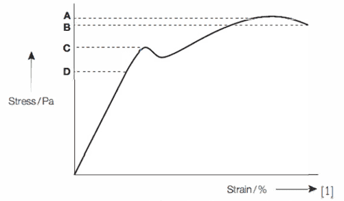

The diagram shows the stress-strain curve for a metal. Which label corresponds to the Ultimate Tensile Stress for this metal?
None
My answer is A but the answer key is B.
I don't understand why B. I would think B is the breaking point.
Is there a difference?
https://en.wikipedia.org/wiki/Ultimate_tensile_strength
Edit… I misread the article at that link the first time. Reading it again, it agrees with you that A is the UTS.

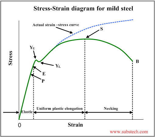

The “Engineering Stress-Strain”curve is misleading in that area. The “True Stress-Strain” curve is what you need to consider.
Likes songoku
A is UTS and B is Breaking point
Likes songoku
Likes songoku and erobz
