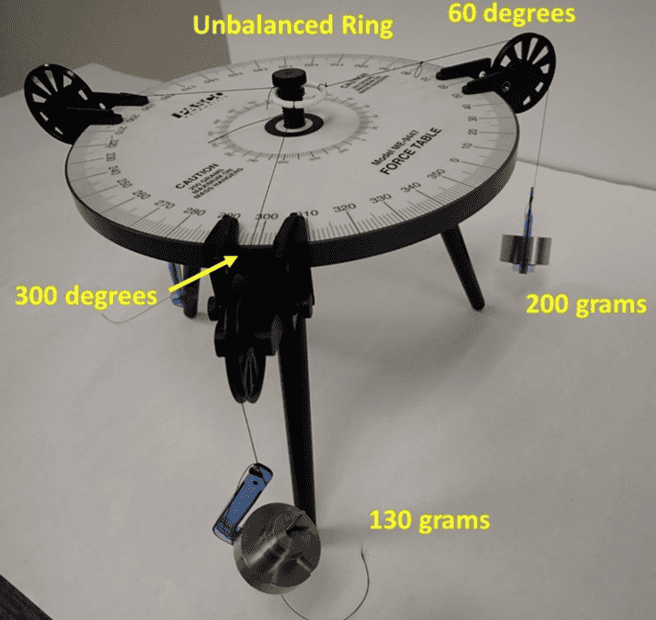

Here is a picture of the situation to show the beginning of the problem:

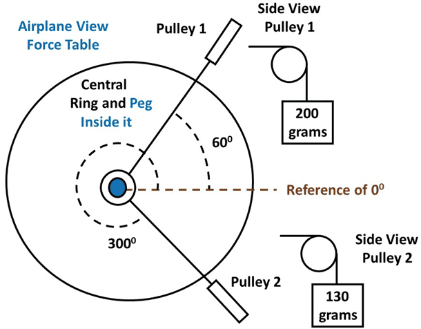

The ring is unbalanced by two masses, a 130 gram mass at 300 degrees and a 200 gram mass at 60 degrees. I calculate that I would need (using the usual force vector math) to hang a 175.78 gram mass at 200.17 degrees to balance the ring (such that it floats and does not touch the center peg). These are my theory values.
Here is a schematic of the situation.

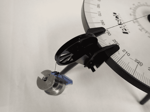

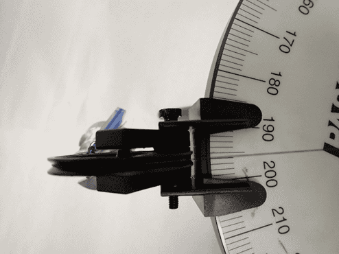

When I did the actual experiment, I measured that the mass to balance my system should be 180 grams at 194 degrees, and you can see that below.
In the left figure you can see that I can measure the angle no better reliably than to one degree; a finer increment than one degree on the force table and I can’t really measure that. In the right-hand side, those masses lumped together total 180 grams. I could put on little disks of one gram or so, but no masses smaller than that.

Angles look like they could be measured ±0.5º (or even ±0.2º with care).
Your reading looks to be 196.0º, not 194º. Check it!
Measured angles in degrees should be recorded to 1 d.p.
