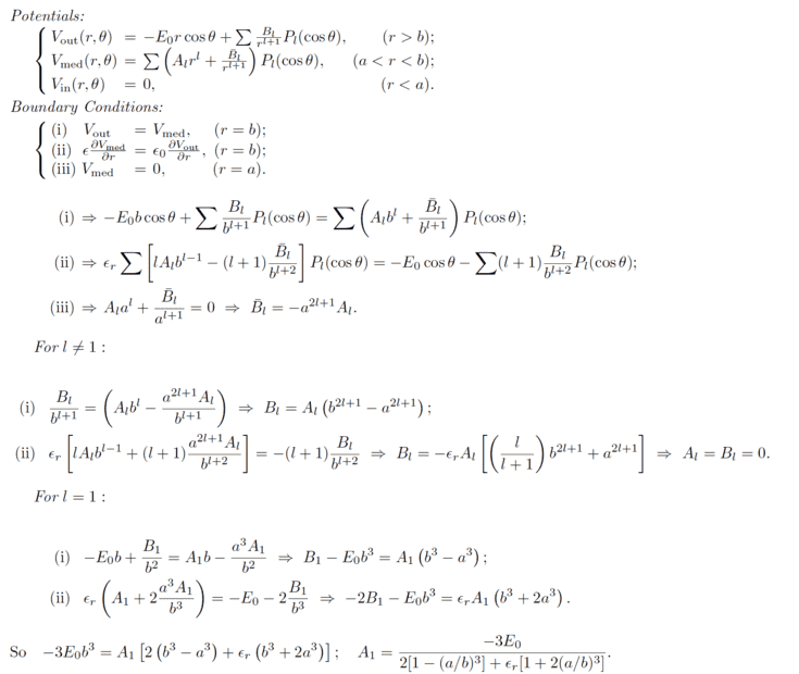

An uncharged conducting sphere of radius a is coated with a thick
insulating shell (dielectric constant r ) out to radius b. This object is now placed in
an otherwise uniform electric field Eo. Find the dipole moment of the conductor.
p = ∫rσ(r)dA.
I worked this problem out in griffiths and my work checks out for for the potentials, b.c. and the coefficients. I will post the solutions just because my work is a little harder to read.
What I am having trouble finding is the dipole moment of the conductor.

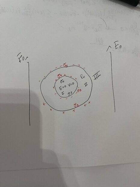

If you know the potentials, you know the fields. The free surface charge density is equal to the discontinuity of the normal component of the electric displacement vector D at the conductor-dielectric boundary.
Likes Delta2

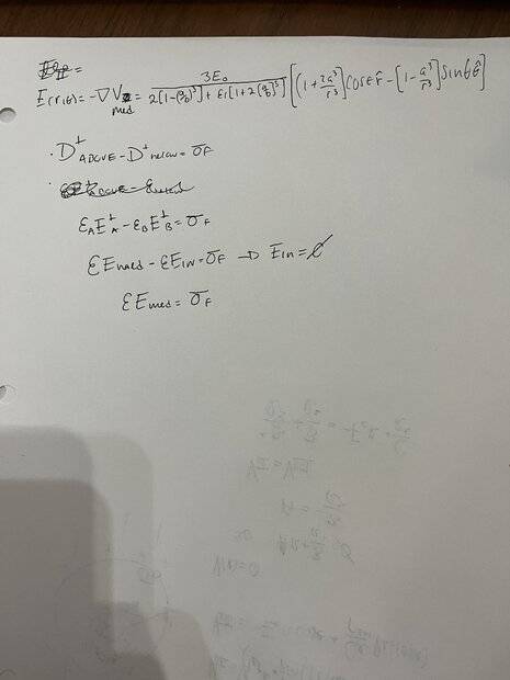

So is it pretty much this? The electric field that i got for the dielectric is confirmed in griffiths.
I know that E inside the conductor is 0.
So the dipole moment would be equal to:
p = ∫rεE(r)*rdrdθ ?
You had it right the first time. The dipole moment is $$\mathbf{p}=\int \sigma(\theta)\mathbf{r}'dA'.$$It's a surface integral - there is no ##dr.##
