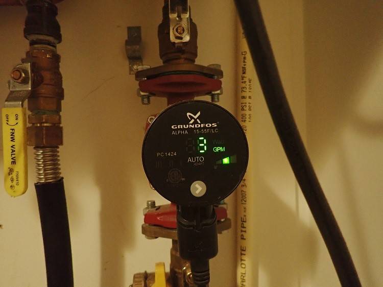

The future was here over 10 years ago. Photo of the Grundfos 15-55F/LC hydronic pump in my house:
It adjusts speed according to the number of open zone valves. The display alternates between GPM and watts. It shows 3 GPM at 24 watts with one zone open, and 8-9 GPM at 35 watts with all three zones open. The pump is self contained. It apparently calculates flow and head from power and RPM, then sets speed to maintain the desired head. This particular model has been around long enough that it is obsolete.
