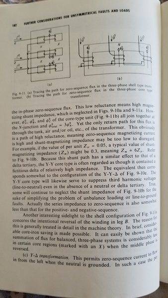

The middle leg of the transformer connected backwards is only done with a 3 phase shell type xfmr. By doing so the flux density is reduced by a factor of sqrt 3.
With 3 legged E core type 3 phase xfmr, the 3 windings are wound in the same direction, no need to reverse polarity.
Same for 3 single xfmrs connected for 3 phase. There is a code for polarity & phase. In North America, wye-wye, & delta-delta xfmr must have 0 degree phase from primary to secondary.
But for wye-delta & delta-wye xfmr, the high voltage side shall lead the low voltage side by 30 degrees phase. This has beern to standard practice for a very long time.

thanks for the input and information, but I'm asking about 3 single phase transformers. do you think the flux density or any impedance would be reduced in a scenario with 3 single phase transformers? I'm not asking if there is a reason to do it, I'm asking if there is a problem if it is accidentally done. i have been told there is (but with no scientific reasoning)
thanks
I think there is no scientific reason for it, because each transformer has it's own independent closed magnetic fluxes and in that case only the stray fluxes can interact with each other which can't be so significant to cause a great disturbing effect on each's operations.
The only reason for it - I suppose from my practice - that there can be an insulation problem and that's why one shall connect they in the right polarity. Of course I suppose that all the transformers are identical.
