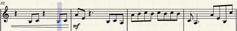

i was wondering how the author's (Linus Åkesson's) program procedurally generates the notes of the melody
The program uses a Linear Feedback Shift Register (LFSR)
https://en.wikipedia.org/wiki/Linear-feedback_shift_register
This is a rather bad random number generator (for music this maybe good), that uses only a single byte for the seed, so it will repeat after at most 256 values.
The following python program reproduces the melody, starting with the last beat of measure 31.

so for example, the speaker (of a C64) outputs note B at half the frequency of note C right? becoming like a physics question lol
and mathematically, what operation is first done to the initial seed value of 65? to express it in terms of just math equations
No, the frequency values for A and B are 16*256 and 18 * 256, so the ratio between them is 9/8 = 1.125, the exact ration for a whole tone in just intonation. On an equal tempered piano that ratio would be 2^(2/12) = 1.1224... You probably can't hear the difference of 0.23% between those.
The e is 1.5 times the frequency of A, and a = 2x the frequency of A.

No, computers work in binary so it actually uses the last 3 binary digits (bits) of an 8-bit pseudo-random number.
This is not BASIC, it is 6502 assembler code (including an undocumented trick). This is not something you are going to fully understand until you are no longer
tade said:
quite the technical noob
@willem2's Python code is a bit easier to read but to understand what's going on you will need to learn about the logical operators AND, XOR (exclusive or) and bitwise shifts. Asking about "mathematical operations" is not going to help.
The SID Chip was amazingly advanced and sophisticated for its time. With the addition of a memory expander, it was quite a formidable little device.
I arranged dozens of songs on it, including the entirety of Bach's Toccata and Fugue in D Minor, using up the entire 512K RAM expansion.
Actually I've just noticed an error or two in @willem2's code so I have rewritten it below with more comments to help you work out what's going on.

No these are the correct notes, starting with the last beat of measure 32. On measures 17-32 the shift register is reset every beat of the kick drum, and the last beat of measure 32 is the last time this happens.
I've noticed the following looking at this shift register.
- A bit shift register like this only produces 1 random bit each time, yet 3 bits are used. if the first bit pattern is
xyz , the next one is ?xy and then you get ??x
One consequence is that each note has only 2 different notes that can follow it, and two different notes that can precede it. A rest 000 alwas has a rest 000 or an 'e' 001 preceding it, and a rest (000) or a B (100) following it, so the last note before a rest is always an 'e' and the last note after a rest is a "B"

tade said:
in the piano video, the melody kicks in at about 0:39, and which number under the "sr." column does this point in time correspond to?
The B on the fourth beat of bar 32 highlighted in the screengrab from the video below is the first (sounded) note of the melody, labelled 2 in your "sr." column.
thanks, and seems like there's something rather odd and interesting

tade said:
hmm seemed like a handy way to play some notes online
Lots of the write-up is nonsense and the key layout is crazy: if "i" is middle C then the logical key for C# (and the one that most other online pianos would use) is "9", not "I".
tade said:
if the note with the frequency of 16 is a D those increases in semitones would correspond with the notes of E, F and A
That is true but in the piano score the note with the "frequency" of 16 is scored as an A (however in the video of it playing on the C64 it sounds closer to Bb: the creator of the piano video presumably sharpened the piano pitch).
There is another complication: between bars 32 and 39 (shown as 64 and 78 in the piano score):
