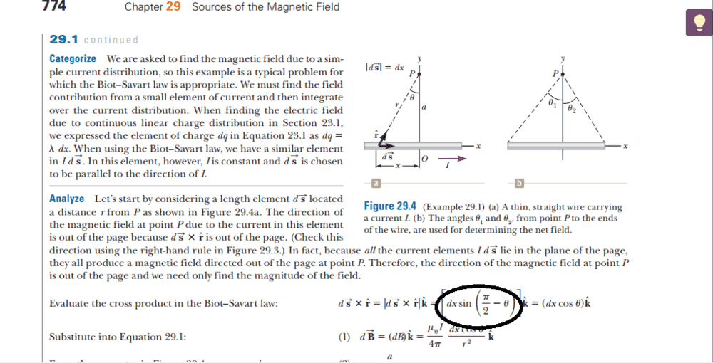

In summary, the authors of the book expressed the cross product between the vectors dl and r (unit vector) as dl sin(pi/2 - theta) because in the cross product formula, the angle between the vectors is represented as sin(angle between the vectors) and in the diagram, the angle between the vectors is (π/2-θ). This explains why the authors put pi/2 into the argument of the sin function.

I can't understand intuitively why the authors of the book expressed the cross product between the vectors dl and r (unit vector) as: dl sin(pi/2 - theta); isn't it supposed to be expressed as: dl sin(theta)?? So why did the authors put that pi/2 into the argument of sin function, that's my question, please check the file I attached
In the cross product formula it is sin(angle between the vectors). In the diagram, the angle between the vectors is (π/2-θ).

That makes sense!; I can't believe I didn't consider that! Thanks!
