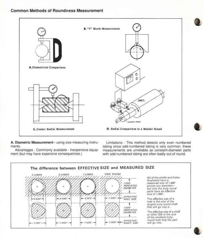

I have been working in this area for a year. A manufacturing company making pipe elbows for the fracking industry had a problem with blow by of the elbow to pipe connection at 15,000 psi. My first question is “ How out of round are the coupling surfaces”.
Castings are machined to tolerance but the control of SIZE is only one indication of functionality. So how does form error or Out of Roundness (ovality, roundness etc..) effect the pipe? The best way to handle stress in all directions is the circle. This is why raindrops are round when they puddle on the sidewalk. The circle resists force ( atmosphere of 14 psi at sea level) equilaterally. If we take this one more step, if the pipe is really out of round then the pipe can not handle force equilaterally. This form error can not be measured with calipers micrometers or V-blocks.
Likes Asymptotic, jim mcnamara and anorlunda
