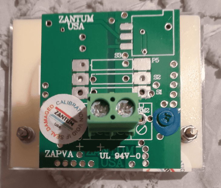

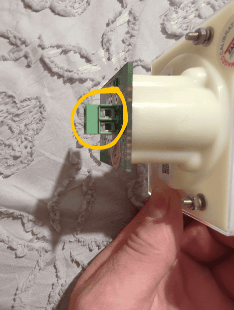

Hello everyone. Maybe you can help me screw my head on with understanding analog voltmeter calibration.
What about getting a known voltage source to calibrate and unscrewing the screws until the meter agrees with the source?
Then test on some other source to be sure.

The 2 screws on the back I thought were for wiring. Sure enough I found out they were calibration screws. I willy nilly began turning them thinking "is this the terminal point?". I still don't know how to wire it and now I've got a $50 paper weight meant to be installed for a parallel battey bank.
Which 2 screws? The 2 philips screws in what looks like a green terminal block? Can you upload a picture with more of a perspective of what that terminal block looks like? It looks like the wire access ports are toward the bottom in your picture...
Since there is a seal that says "calibration void if seal damaged" on the PCBA itself to the left of that terminal block, I'm guessing that those 2 terminal block screws do not have anything to do with calibration... (but the perspective picture is needed to be sure)

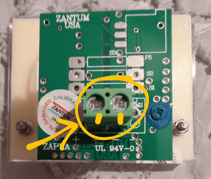

Yes these 2 screws on this green thing. Now I'm being told they ARE negative and positive terminals. This, after I was told they were calibration screws but I think they mistook thinking I meant the blue locktite set screws on top in the photo here I'm uploading.
EDIT: I can't seem to upload new photos. security error?

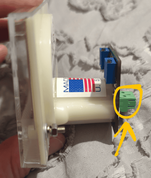

Can you upload a picture that shows that green terminal block and screws in perspective? Are there openings in the green terminal block for wires to be inserted?
yes I had to edit my last repy. I uploaded 3 new photos
Good, so yes those are just the screws for the terminal block for attaching the sensing wires to your battery.
Why do you think the meter is out of calibration? Have you attached it to anything yet?
The seller on ebay for this Zantum Model ZAPV15B class 0.5 just told me the blue is the wire terminals. Is this correct? I think maybe he thought I was talking about the blue screws that are set in locktite that you see sticking out the top.
I guess this was a misunderstanding. The seller assumed I turned the blue terminals on top. So I guess its still in calibration. The BLUE set screws that are glued in place are the calibration screws.

Having used that type of terminal strip in both blue as well as the green shown in your pix, it's possible the seller had seen both varieties.
Yes, in this case I think he assumed I turned the glued in place micro flat head screws.

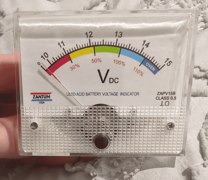

Heres something really funny though. I understand now these screws on the green box are just back off and back on tension for the + an - connections or "sense" wires. However when the dial is perfectly tuned to zero, if i unscrew or screw in those screws it makes my needle go above zero. Then i have to adjust the screw to set it back to zero. Is this normal or is the zero screw on front way to sensitive, being a 0.5 class?
That doesn't sound normal, so probably something else is going on. Like the mechanical stress of your torquing those connection screws is bending the overall structure or something like that. Take it easy on those screws! :smile:
Maybe it is the way you support the meter while tightening the screw terminals.
Check that the new plastic (uncontaminated) front of the meter is not influencing the pointer through electrostatic charge. Wipe the front window with the tip of a dry finger, or approach it with a friction-charged ball point pen. Does the zero change?
If it does, dab one drop of glycol antifreeze (which is hygroscopic), on the window to discharge the surface charges. Only the smell of glycol is needed on the inside of the plastic to reduce the electrostatic influence.

Thanks for this! Thats genius. This turned out to be the issue. The voltmeter was on my comforter on my bed developing static. I verified this by running finger over the cover and the super fine needle dropped! holy cow.
Previously having worked for a test equipment company I recall panel meters having trouble with static causing the needle to "stick" in places off of zero. Hadn't thought of that problem for a long time.
Wow that is nuts! I also touch the back of the curicut board and the needle instantly falls back to zero!
So glad you told me this. this would've drove me mad had I not known. So this illustrates the importance of these 0.5 class voltmeters needing to be installed rather than handled. Slightest static causes the needle to "float" making it seem like it needs correction.

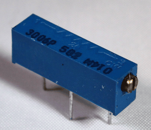

Those blue things are trimpots. They do the calibration.
Like this:
Like this:
Yep, mine looks almost exactly like that only the screws have blue hardened epoxy glue or locktite on half of it. Same brass screws. Now i know not to touch that area. Thank you for all the valuable info.

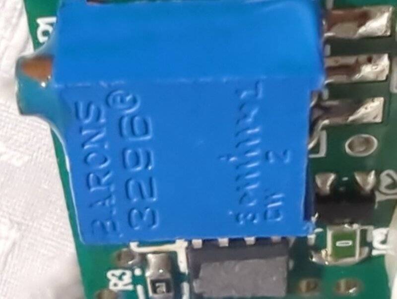

I have not seen the internal electronics used with that meter, but judging from the non-linearity at the bottom of the scale, I would say that about 9.6 volts is being dropped by a Zener diode in series with the meter. It seems the Zener voltage is a bit off. It is possible that they may have adjusted meter physical zero to correct that. If that is the case, then when you adjust the zero, you upset the original calibration by those two divisions.
It would be interesting to see the circuit used to expand and calibrate the scale of that Zantum meter.
The voltage offset that expands the scale should come from a precision voltage reference, such as an LM4040 +5V device. Three of those, in series, would give you 10V and 15V references for use checking your meter. They are available in different accuracy grades.
I would use one or two of the LM4040 precision references to provide the 10V meter offset, and a third to establish a 15V full-scale check voltage. That would require the linearity at the bottom of the scale be corrected, by moving the 10V mark back to the physical zero.
Very good points. this meter has a Barons 3296 square trimpot potentiometer. Its sealed meaning its almost solid state even though it has moving screws. It has 2 of these potentiometers. one sets the voltage at 10v within 0.01% accuracy. The other tops it at 15v, same deal. its a small scale but wide window for great accuracy. Its like the brain of the whole meter. Its calibrated at +0.01% increments which gives it that 0.5 class status. Anything better is thousands of dollars.
So according to the PDF on this trimpot, the calibration (accuracy) stays exact no matter what you do with the front zero setting dial. The zero doesn't cause a upset in the calibration, it merely resets whats called "mechanical zero". We hear this term used a lot in mechanical plumbing. Mechanical zero is totally independent of calibrated zero. Thankfully. So if I zero it to 1 volt it'll be 1 volt off but the internal resistors are still operating independent of what mechanical difference interferes. It'll still react according to the resistance feedback.
Things like static, shock (force), vibration can goof up mechanical zero quite often but the potentiometer continues its calibrated response.

No no no, I've already found that this green box is for the wires. There is nothing wrong with anything else.
I was only trying to figure out wiring on it.
The 2 blue trimpot potentiometers are the calibration points and they're fine :]
