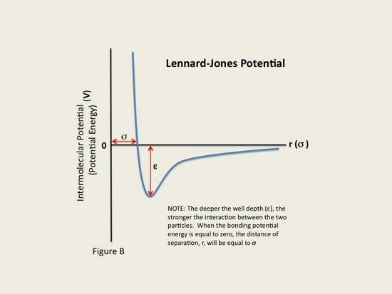

The potential energy of intermolecular bonds is often modeled as a Lennard-Jones potential, which has the following shape:
(note that the interaction between water molecules involves hydrogen-bonding so it is probably more complicated than an L-J potential)
Remember that force (F) is given by the equation: ##F = –\frac{dV}{dr}##, so the force is given by the derivative (slope) of the potential energy function (V). At distance ##r_{eq}## where V is minimum, the atom experiences no net force (because attractive and repulsive forces cancel out). As the distance between the atoms increases from ##r_{eq}##, the atom experiences an attractive force that increases to some point, but then begins to decrease again to zero as the two atoms become very far apart.
2) Does the kinetic energy get converted to potential energy because the molecule it was bonded to is opposing its motion?
Unbound atoms have a higher potential energy (zero in the diagram above) than bound atoms (-ε in the diagram above). Therefore, heat gets converted to potential energy when you break an intermolecular bond.
