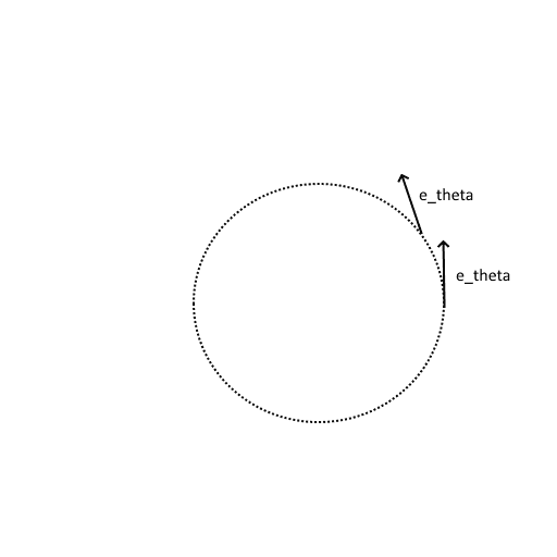

well, @Orodruin did give an example, but I will try to make it very explicit.
First, you said you haven't dealt with parallel transport yet. However, in the simple case of a flat Euclidean plane, the concept is really simple: moving a vector around without changing its direction or magnitude. This notion doesn't depend on any coordinates placed on the plane.
Now consider cartesian coordinates. The x direction and the y direction are 'basis vectors'. They exist at every point. Cartesian coordinates have the property that the basis vectors at one point, parallel transported to another point, are the same as cartesian basis vectors at that point. More simply, the x and y directions don't change from point to point.
As a result, if an arbitrary vector is moved from one point to another, its projection on the that point's basis vectors don't change.
Now consider polar coordinates, superimposed on Cartesian coordinates. Along the x axis, the radial direction is in the x direction and the tangential direction corresponds to the y direction. However, along the y axis, the radial direction is the y direction, and the tangential is the negative x direction. So If you move, e.g. the vector (x,y) = (1,2) from somewhere along the x-axis to the y axis, its representation in cartesian coordinates doesn't change, but in polar coordinates it changes from (r,θ) = (1,2) on the x-axis to (r,θ)=(2,-1) when moved to the y axis. This is necessary to prevent its direction from changing.
The connection coefficients tell you how the representation of a (parallel transported) vector changes from point to point as the basis vectors change direction. They vanish only if the basis vectors don't change from point to point.
NOTE: all of this discussion is restricted to the flat space situation. I have deliberately glossed over additioanl issues that arise in curved space because you specifically asked about non-Cartesian coordinates in flat space.

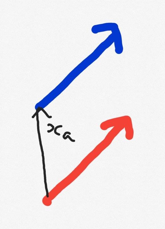

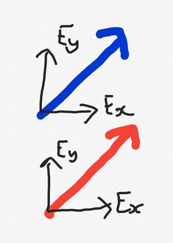

Sometimes a diagram is useful. I apologise for the hand-drawn nature of this, but hopefully it's clear enough. It's more or less a restatement of @PAllen's last post.
Here are two vectors at points on a Euclidean plane, one red and one blue. I've added the vector ##x^a## (which I realize I accidentally wrote ##x_a## in the diagram, but I'm not going to try to fix now) which points from one point to the other.
The red and blue vectors are in some sense the same - they point in the same direction and have the same length. And if you use Cartesian coordinates and the matching basis vectors they are indeed both expressed the same way. In the diagram below I've shown Cartesian basis vectors, and it's clear that the red and blue vectors have the same expression in this basis - something like ##(L/\sqrt 2,L/\sqrt 2)## where ##L## is the magnitude of the vectors.
However, this is not the case in all bases. Below, I've added a polar coordinate system and basis - radial lines to the tails of the vectors are shown in grey, and the basis vectors again in black.
In this system, the basis vectors ##\vec E_r## and ##\vec E_\phi## are not the same at different positions, so vectors that are the same are not written the same way. The red vector is something like ##(0,L)## while the blue vector is more like ##(\sqrt 3L/2,-L/2)## - even though they are still the same vectors I drew in the first diagram. There is no such difference in a Cartesian basis, so the Christoffel symbols are zero. But in the polar basis the components do differ and the Christoffel symbols are non-zero.

So let's look at an example. In particular, let's look at ##\Gamma^r{}_{\theta\theta}##. We've just worked out what the value of ##\Gamma^r{}_{\theta\theta}## is, it's equal to -r. See vanhees' post.
vanhees71 said:
from which you immediately read off that
$${\Gamma^{r}}_{\theta \theta}=-r, \quad {\Gamma^{\theta}}_{r \theta} = {\Gamma^{\theta}}_{\theta r}=\frac{1}{r}.$$
So, it's saying that the basis vector ##\vec{e}_{\theta}##, when we move it in the ##\theta## directions, needs to add a bit of the vector ##-\vec{e}_r##.
This is because ##\partial_{\theta} \, \vec{e}_{\theta}## is equal to ##\Gamma^r{}_{\theta \theta} \vec{e}_{r}+ \Gamma^{\theta}{}_{\theta \theta} \vec{e}_{\theta}## = -##r \, \vec{e}_{\theta} + 0##
A diagram might help. We draw ##e_{\theta}## at theta=0, and again with ##\theta > 0##. We see that this is in fact correct.
One thing that will most likely confuse you is that ##e_{\theta}## isn't in general a unit length vector. To see this, look at the dot product ##\vec{e}_\theta \cdot \vec{e}_\theta = r^2##. However, in the diagram above, you can consider that we are drawing ##\vec{e}_\theta## at r=1, so in this particular diagram it is unit length.
It is hopefuly obvious what direction ##e_{\theta}## points in, but you also have to get it's length right when you use a coordinate basis. Orthonormal basis are more physically intuitive, but you get stuck with the coordinate basis in order to use some very useful formulae for covariant derivatives, a topic that's coming up shortly7 in your course, I'm sure.
Likes JD_PM and vanhees71
