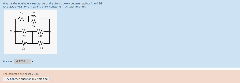

I can say that the resistance of bR is 34.04 and aR is 44.16. The answer to the question is 22.82, but I don't know the steps to get there.
Looks to me like the given answer may be incorrect. This happens sometimes when problems are "refreshed" by the publisher and answer is not updated.
Where did the values of aR and bR come from, a previous question step in a larger problem?
Its a distinct question. Ill just attach the whole thing here.

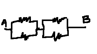

I’ve just done it and got the official answer of 22.82 Ω . Though I would point out this should be rounded to 23 Ω to match the significant figures in the data. Also the original question says ‘Ohms’ which is wrong; it should be written using lower case: ‘ohms’.
Imagine shortening the vertical wire (in the middle of the bottom two rows of the circuit) to a point (P). This has no effect on the currents/voltages in the rest of the circuit.
It should now be clear you have [aR and bR in parallel] on the left of P and [aR and bR in parallel] on the right of P.
These two parallel pairs are in series.
Does that help?

I agree with the answer given 22.815Ω.

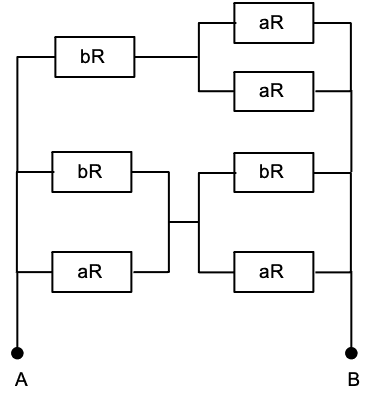

DaveE said:
That's good, so far. But, there are other resistors too; you've now reduced the circuit from 7 to 4 resistors.
Sure but the other resistors arent between A and B. Furthermore my answer is already too big, adding more resistors would only make it bigger.
You can't draw a path starting at A and going through those "other" resistors to B?

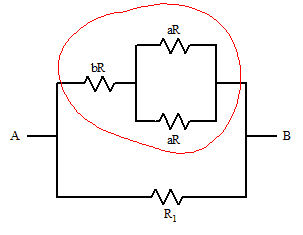

What value did you get for the net resistance of the bottom four resistors? Let's call that R1. Then your circuit is reduced to:
and you'll now want to move your attention to the upper branch circled in red. Reduce that to a single resistance value. What will the resulting "reduced" circuit look like then?

Do you see why the circuit below has the same equivalent resistance between A and B as the original circuit?

both ends of the line in the middle represent the same point, because they are at the same potential.
you have a pair of two parallel resistors.
