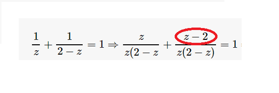

sign error
Likes lamefeed

SammyS said:
@m4r35n357 What post was this referencing ?
Oops, #10. I don't get it!
In Post #10, the last step I showed gave :
So your equation becomes ##\displaystyle \ \ \ 1- \frac {10}{z + 3}=i \,.\ ##​
From there, isolate the.term with z+3 .
##\displaystyle 1-i= \frac {10}{z + 3} \,\ ##​
.then
##\displaystyle z + 3= \frac {10}{1-i} \,\ ##​
Rationalize the denominator & simplify.
Ah, OK thanks. I would have counted the "exchange" of terms as equivalent to (potentially) multiplying by 0, just like the solution I got, but then I'm no mathematician!
