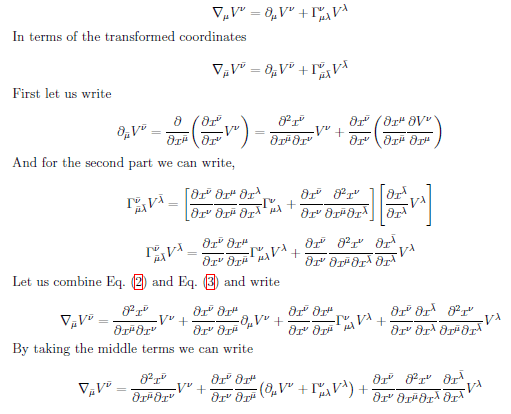

I am was doing inverse operations of these equations (showing that ##\nabla_{\bar{\mu}}V^{\bar{\nu}}## transforms as a tensor) and I have obtained something like this
There are extra two terms which I cannot explain why are they. The only logical explanation seemed to be that the ##\frac{ \partial x^{\bar{\nu}}}{\partial x^\nu}\frac{\partial x^{\mu}}{\partial x^{\bar{\mu}}}## must act as a differential operation on ##[\partial_{\mu}V^{\nu} + \Gamma^{\nu}_{\mu \lambda}V^{\lambda}]##

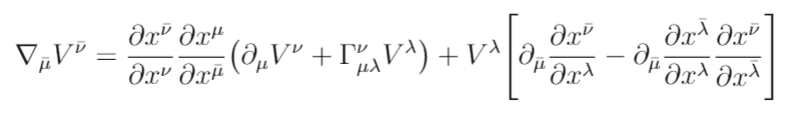

I was doing these calculations
and the first and the last terms seems extra. Are they 0 or am I missing something in this derivation ? Thats actually why I asked this question but it seems I am doing something wrong..
As you know to show ##\nabla_{\bar{\mu}}V^{\bar{\nu}}## transforms as a tensor I need to write it as $$\nabla_{\bar{\mu}}V^{\bar{\nu}} = \frac{ \partial x^{\bar{\nu}}}{\partial x^\nu}\frac{\partial x^{\mu}}{\partial x^{\bar{\mu}}}\nabla_{\mu}V^{\nu}$$ which I cannot do at this moment
Although they were a little sloppy re-using the index ##\lambda## in their fourth line of equations, the working in the image looks okay? I have the feeling the first of those terms vanishes, because
$$\cancel{\frac{\partial^2 x^{\bar{\nu}}}{\partial x^{\bar{\mu}} \partial x^{\nu}} = \frac{\partial^2 x^{\bar{\nu}}}{ \partial x^{\nu} \partial x^{\bar{\mu}}} = \frac{\partial}{\partial x^{\nu}} \delta^{\bar{\nu}}_{\bar{\mu}} = 0}$$however I don't know how to show the second of those terms vanishes. Let's hope someone gives a hint! :smile:

I suggest not writing things like
\frac{\partial^2 x^{\bar \nu}}{\partial x^{\bar \mu} \partial x^\nu}
with derivatives that are using different coordinates as they generally do not commute. What you want to write is instead something like
\partial_{\bar \mu} \frac{\partial x^{\bar \nu}}{\partial x^\nu}
as it is much clearer what is intended.
I suggest you do the following:
  1. Rename the dummy index ##\nu## in the first term to ##\lambda##. This will allow you to factor out ##V^\lambda## from the superfluous terms.
  2. Note that $$\frac{\partial^2 x^\nu}{\partial x^{\bar \mu} \partial x^{\bar \lambda}} \frac{\partial x^{\bar \lambda}}{\partial x^\lambda} = \partial_{\bar \mu}\left( \frac{\partial x^\nu}{\partial x^{\bar \lambda}} \frac{\partial x^{\bar \lambda}}{\partial x^\lambda} \right) - \frac{\partial x^\nu}{\partial x^{\bar \lambda}} \partial_{\bar\mu} \frac{\partial x^{\bar \lambda}}{\partial x^\lambda}$$ and go from there.

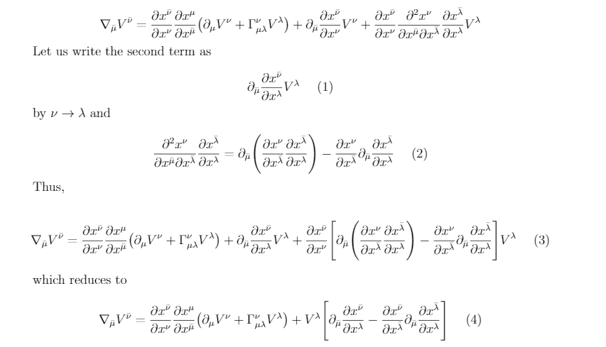

Let me try that, thanks for the info

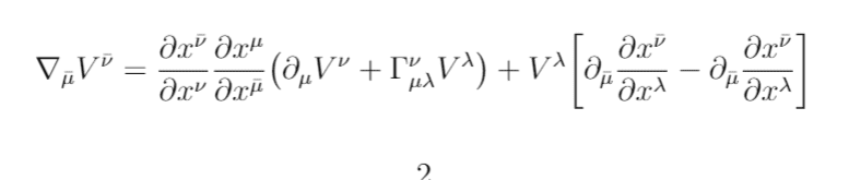

Ah, I think I got it with the hint! @Orodruin why don't the partial derivatives with respect to different coordinates commute?
I get this..
Can we eliminate ##\partial x^{\bar{\lambda}}## and write
otherwise I am stuck.

That's just applying ##\partial x^{\bar\nu}/\partial x^{\bar \lambda} = \delta^{\bar\nu}_{\bar \lambda}## (alternatively, the chain rule).
I see. Since $$\partial_{\bar{\mu}}(\frac{\partial x^{\bar{\lambda}}}{\partial x^{\lambda}})\frac{\partial x^{\bar{\nu}}}{\partial x^{\bar{\lambda}}}$$ I thought we may not apply it here. So the problem is solved I guess. Thank you all for the help
Note: For instance if I not write ##\delta^{\bar{\nu}}_{\bar{\lambda}}## and just cancel is it wrong?
If that is what you got then you got something different from me. I would expect both of the derivatives to be acted upon by the ##\partial_{\bar\mu}##. Can you post your work?
Likes etotheipi
Right, sorry. It is still using that ##\partial x^{\bar \nu}/\partial x^{\bar\lambda} = \delta^{\bar\nu}_{\bar\lambda}##, which is a constant that can be freely moved inside the derivative. It is, however, not using the chain rule.
Likes Arman777
Okay then, nice.
