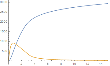

Here's a graph of the position (blue) and velocity (orange) as functions of time for the case where both the the applied force and drag force act for 0 < x < 2000 m. For x > 2000 m, the applied force is assumed to be zero and only the drag force is acting.
The horizontal axis is time in seconds. The vertical axis is distance in meters for x and velocity in meters per second for v.

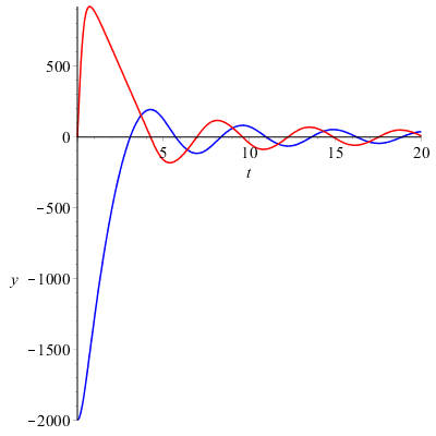

I am more interested in the (physically more realistic) case where the form of ##F## applies also for ##x > 2000## m. In the absence of drag, the resulting dynamics would be a simple harmonic motion about the point ##x = 2000##. For example, with mass ##m = 70## (kg) and starting from ##x(0) =0## with velocity ##v(0)=0##, the motion is periodic with amplitude 2000 (m) and period ##p = \pi \sqrt{70}/7## sec, which is about 5.257 sec..
The effect of drag is most easily seen by looking at the new "displacement variable" ##y = x - 2000##, because in the absence of drag the values of ##y(t)## oscilllate with amplitude 2000 about the point ##y = 0##. With drag given as above, the nonlinear second-order differential equation satisfied by ##y = y(t)## is
$$70 y'' = - 100 y - 0.18\; \text{Sign}(y')\; y'^2$$
Solving this in Maple (using a numerical method) gives the following solution.
The blue curve is ##y(t)## while the red curve is ##v(t) = y'(t)##. We started from ##x=0## with initial velocity 0, so the initial value of ##y## is ##-2000##.
We can see the damping effects of drag, with the amplitudes of the oscillations lessening as time passes, and the velocities (speeds) also slowing over time.

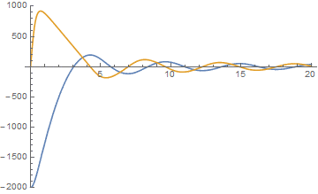

That's nice. As a check, I get the same graphs (Mathematica).
Note: I wrote ##y''## in the posting, but the actual left-hand-side should be ##70 y''##. The Maple solution used the correct "70" form. I have corrected the posting in an edit.
