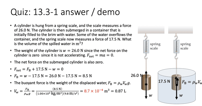

Here's a example where I keep getting hung up on.
Fnet=ma=FB-W
The example gives Fnet = FB + 17.5 N - W = 0
where did ma go? Why is the zero placed on the far right?
my interpretation using my given equation sheet is: 0 = FB + 17.5 N - W, because we know Fnet = 0
You shouldn't get hung up on this: ## F_B + 17.5 \mathrm N - w = 0 ## is the same as your interpretation ## 0 = F_B + 17.5 \mathrm N - w ##.
Same answer to both questions. You are given the system is static, so ma=0.
Fnet=ma=FB-W
The term ma (mass times acceleration of the body) could have still be shown, if of any interest.
The proper relation should be understood as
Acceleration of a body = Net force acting on the mass / Mass
Meaning that, any body will be accelerated in direct proportion to the net force (vectorial summation of all the forces) acting on it, and in inverse proportion to its mass.
It is not always like that, but in the shown case, the vectorial summation of all the forces (upward direction is assumed to be positive and downward to be negative) happens to be zero.
The mass multiplied by zero is zero; therefore, the ma term can be eliminated form further calculations.

Thank you, I really appreciate it. Light bulb moment
