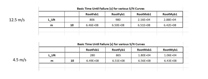

Some basic background before i ask the question. I have been using openFAST, am opensource software to simulate a 5MW wind turbine. I then use the data from openFAST, and run it through its counter partner Mlife, to calculate fatigue and time to failure.
Below is the data that Mlife dumped to an excel file. time is in seconds, so 6.5*10^8 seconds is 20 years'ish. m is the Woeller exponent. RootFxb1 is the force in x direction at the root of blade 1. RootMxb1 is the moment.
Here is what i am trying to understand. At 12.5 m/s, the ultimate load is 806kN and will last roughly 20 years, but at a MUCH SLOWER wind speed, the ultimate load is drastically reduced to 280kN, but still lasts 20 years. This tells me that at slower wind speeds, the blade is weak and can only handle 280kN. This seems wrong because the ultimate load should be 806kN no matter the speed.
IE, if the blades ultimate load is 806kN, then at 0 wind speed, the blades ultimate load should still be 806kN. So why is the ultimate load so different?
nothing settings wise has changed at all besides changing the wind speed. (not that you guys know the software, just an fyi)
not sure if this helps or not, But for the wind speed of 12.5m/s, i would adjust L_ult for all 4 categories (RootFxb1 etc etc) until the time was 20 years.
thanks for any help understanding the data

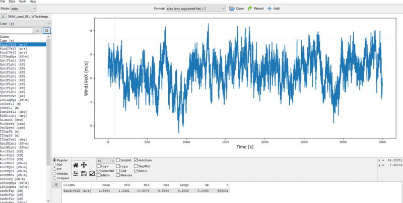

Does your software have a curve for frequency of wind vs velocity of wind? There should be a lot more time at 4.5 m/s than at 12.5 m/s, so more fatigue cycles. That, plus the Woeller exponent could explain the results.
both wind files that i generated were set for 3600 seconds of wind for each respective speed. So both time series data had 60,000 time stamps or close to it.
Here is the only graph i have of the wind:)
thanks

the theory manual defines L_ult or ultimate load is as follows:
where L_ult is the ultimate design load of the component.
thats all the information i can find. If it means the ultimate stress over a cross section, then when i try that number, my life time is infinite since it spits out 726,000,000 years as the result. So i personally think the L_ult is the max loading that occurs in the time series data.
What i did was kept adjusting the L_ult in the software until it spit out a time of 20 years. So for a wind of 12.5m/s and a MAX loading of 444kN on the blade during the time series data, it says the L_ult is 806kN to get a lifespan of 20 years.
But if i test out the data for a 4.5m/s with a MAX loading of 180kN, it spits out a L_ult of 280 for a life span of 20 years. This seems way way off. At slower speeds, those blades should be able to hanlde more than 280kN
I have the software setup to look at the root of the blade where the threaded m45 studs are. Here is a picture:

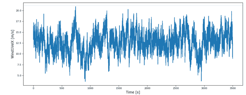

Here is an image of what openfast calculates based on the wind file of 12.5m/s. The left hand side are are the different output channels and their associated graphs.
All i have to do is edit a basic text file and have it point to the wind file, then openfast does the rest.
Mlife then takes the data generated from openfast and computes the fatigue based off of the channels i tell it to use. I was informed to use RootFxb1, RootFyb1, RootMxb1, and RootMyb1 as the channels for it to use.

The user manual for openfast and mlife say "ultimate load"
The dev of OPENFAST told me via the GitHub forums that ultimate load can be found 2 ways.
First is FEA
And second is by taking the max load of the time series data, and scaling it by a factor, until your life time hits 20 years. This is the method I went with since I do not have fea.
I just find it odd that at such low wind speeds the L_ult is 280 while L_ult of the faster windspeed is so much higher.
I have double checked all settings in openfast and all are the same except the windspeed.
