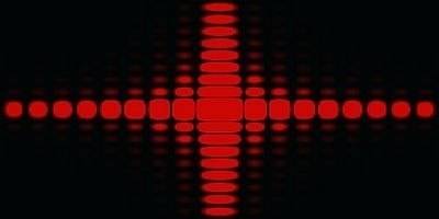

Yes - I agree but...
In the slot images of my first post the slit is either short or the width of the laser beam is visible - we can tell this from the fuzzy fringes in the y-axis. Note there is no interference indicated above and below the slit - but there should be given the width of the fringes in the x-axis and y-axis are comparable - so there should be intense light above and below that is missing...?
Also, as you say, as the width of the slot increases the interference pattern should become closer together. Consider now rotating the x - axis distribution function incrementally around to the y-axis position. If the aperture is a circle, we can see how this x-axis rotation of the probability distribution would create a circular airy's style image. But if we make the opening a slit - as we rotate the prob distribution the apparent slit width increases, bringing the fringes closer together - so shouldn't we see some curving on the top and bottom of the interference pattern?

"If the same method is used in calculating the slot diffraction as you use in the circle then then slot diffraction should also be radial (but stretched to account for the slot height)"
Not so. It makes sense for a circular aperture to have a diffraction pattern with circular symmetry and a linear slot to have one with cartesian symmetry. Diffraction patterns in the far field can be calculated by taking the 2D Fourier transform of the aperture function (transmission as a function of position).
Looks to me like the height of the slit is larger than the diameter of the laser beam. (Isn't the picture that's inset on the top left a picture of the slit?)
I don't know what you're trying to say here. What is "apparent slit width" and how is it increasing?
