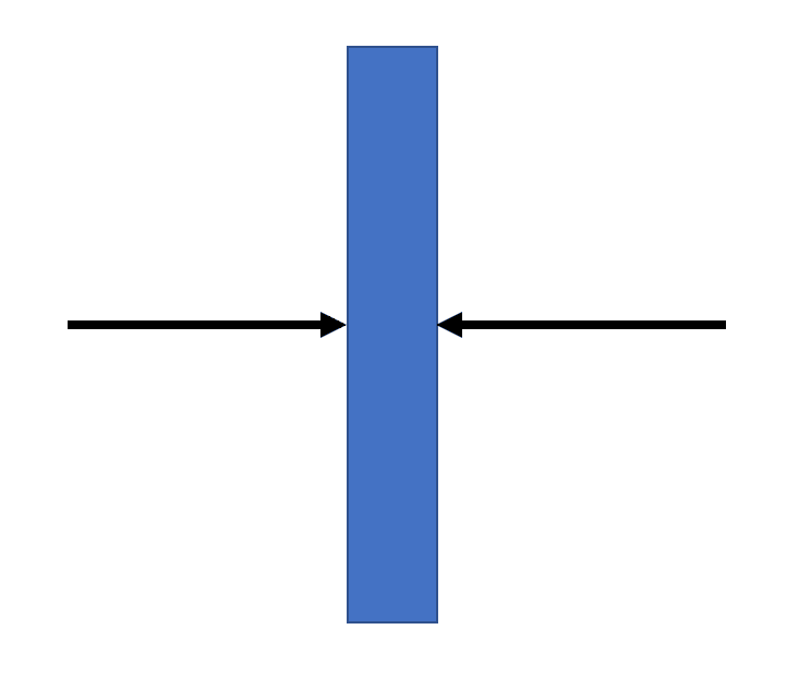

So this is where I am stuck. I have checked many solution's on the internet and they say that the key is to realize that the normals ##n## in Gauss's law equations are pointing out of the conductor (actually, Jackson says: "where ## \frac {\partial} {\partial n} ## is the normal derivative at the surface S directed outwards from inside the volume V"), whereas the normals in Green's theorem are pointing into the conductor, so you can flip the - signs to end with the identity you want to prove. This is how I picture this (not sure is this correct):
Why is this the case? This made me realize that I don't understand how to derive Green's identity as I don't get why we are considering the normals in that direction. And, if my drawing is correct, we are only changing the sign inside the conductor where ## E = 0 ##, so why does this even matter?

peguerosdc said:
...actually, Jackson says: "where ## \frac {\partial} {\partial n} ## is the normal derivative at the surface S directed outwards from inside the volume V"...
Since ##V## is a non-conducting region bounded by a conducting surface (or surfaces), Jackson's statement implies that the normal derivative ##\frac{\partial}{\partial n}## at the surface is directed into the conductor.
And used ... ## \frac {\partial \phi} {\partial n} = - \frac \sigma \epsilon ## between the surface charge density and the electric potential
The negative sign on the right occurs when the normal derivative on the left side is directed out of the conductor. But this normal direction is opposite to ##\frac{\partial}{\partial n}## as is being used in the current application of Green's second theorem where the normal derivative is into the conductor. So, you have ## \frac {\partial \phi} {\partial n} = + \frac \sigma \epsilon ## if ## \frac {\partial} {\partial n} ## is in the direction as used in Green's second theorem.

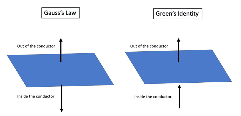

So, just to confirm, would this be a correct sketch of the direction of the normal direction according to Green's theorem?
Yes. Of course, in some texts they might take the normal direction to be in the opposite direction but make up for it by changing signs in the statement of Green's theorem.
