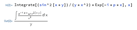

But, how did you get such a result? I could not solve the integral so I used Mathematica and it seems it does not process it (I may have typed something in the wrong way though)
I used another website to compute the integral, Integral Calculator, but did not solve my doubt.
