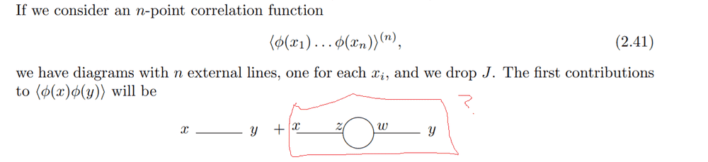

Here I start to get lost, as when I checked Osborn notes, he shows a diagram with a loop
Why do we get a diagram with such a form? How can we deduce it from knowing that we have with two propagators and the external legs ##iJ(x), iJ(y), iJ(t), iJ(\xi)##

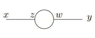

Hm, the diagram you look for must of course be a contribution at ##\mathcal{O}(\lambda^2)## with only two ##J##'s, i.a., the diagram is
$$\propto \int \mathrm{d}^4 z \int \mathrm{d}^4 w J(x) \Delta_F(x-z) \Delta_F^2(z-w) \Delta_F(w-y) J(y).$$ So you must have forgotten some terms in the derivatives.
Thank you very much for giving the answer!
As I suspected, this computation was not going to be straightforward 😅. I am struggling a bit on how to deal with squared derivatives.

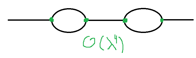

PeterDonis said:
There is only one second order diagram: two external legs, a loop in the middle, and each external leg going into its own vertex on the loop, so two vertices. (Again, I suggest thinking carefully about this until you realize why this is the only possible second order diagram.)
Mmm again really interesting. I would argue this one based on Euler's formula. We have the number of vertices fixed so ##L = I -2 +1##. A negative number of loop (I think) does not make sense so at least we need to start with ##I=1##. In that case ##L =0## and we recover the zeroth order. If we set ##I=2## we get ##L=1##, which is precisely the diagram you pointed out i.e.
I would say this is the unique diagram for ##\mathcal{O}(\lambda^2)## because is the only one satisfying Euler's formula.
Mmm but I think you will not be completely satisfied with my answer, given that Euler's formula only works with connected diagrams. So please feel free to add more insight :smile:

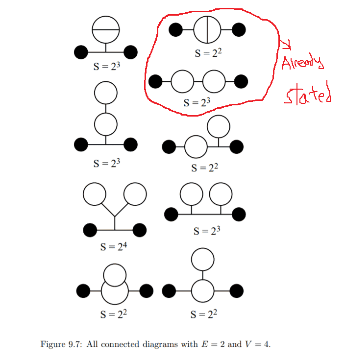

Actually, why should not we go a bit further? Let's say we want to find diagrams for ##\mathcal{O}(\lambda^4)##. I would again make use of Euler's formula; we know that ##L = I -4 +1##. So given that there can only be 2 external legs, the only diagram I see that satisfies ##L = I -4 +1## for ##\mathcal{O}(\lambda^4)## is ##I = 5## i.e.
Do you agree so far?
PeterDonis said:
If you are studying scattering, you have four external legs, and there are now two zero order diagrams (i.e., diagrams with no vertices). There are still no first order diagrams. (Can you see why?) There are now three second order diagrams. (Again, can you see why?)
Please let us first ensure the above is correct. I will of course argue these then.
I'll have to consider this and the rest of your post. At a glance, your statement of Euler's formula doesn't look correct for the zero order case; the only ##V = 0## diagram has ##I = 0## (no internal lines), but your formula says it should have ##L = 1## (one loop), and it doesn't.
As far as whether the diagram you gave is the only possible fourth order diagram, no, I don't agree. There is at least one obvious fourth order diagram (a connected one, so the issue I'll mention in the next paragraph doesn't apply) that you have missed.
In fact, now that you've reminded me that we should also consider disconnected diagrams, I'm not even sure there is only one second order diagram.

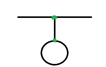

PeterDonis said:
There is no first order diagram for the ##\phi^3## theory for this case because it is impossible to have a diagram with two external legs and one vertex.
In ##\phi^3## we need every vertex to be connected to three lines. Hence a diagram with two external legs with only two vertices is not allowed.
I think you mean only one vertex.

PeterDonis said:
Where have you read this? The usual presentations of Euler's formula talk about vertices, edges, and faces, and the formula is ##V - E + F = 2##.
Osborn notes, page 24
PS: I have been studying the ##2-##point function for ##\phi^3##. I will share it to check my understanding
JD_PM said:
Hm. His definition of "connected" vs. "disconnected" graphs seems to match mine (see the discussion and examples on p. 26--all of the examples there have four external legs, not two, but the pattern seems clear). But it is still the case that the zero order diagram we have been using for the case of two external legs does not appear to satisfy his version of Euler's formula, even though it is connected by his definition. So I am still not sure about that formula.
Likes JD_PM
To be clear, what I'm not sure about is not Euler's formula for planar graphs itself; that's a well known mathematical theorem. What I'm not sure about is how to count loops, vertices, and internal lines in Feynman diagrams in order to correctly apply the formula to them. It's possible that the formula simply does not apply to the zero order 2-external leg diagram, with ##I = V = 0## (since by the formula that diagram should have one loop), or in general to diagrams with no internal lines and/or no vertices.
Likes JD_PM
Yes, I was going to reply a similar idea: I suspect Euler's formula does not apply to non-interacting diagrams (i.e. diagrams coming from the free Lagrangian density).

  • Second order (##\mathcal{O}(\lambda^2)##)
A connected one-loop diagram
This is the unique diagram because there is no other way of connecting two external legs with two vertices, which have (each) three lines associated to it.
  • Third order (##\mathcal{O}(\lambda^2)##)
There is no contribution
  • Fourth order (##\mathcal{O}(\lambda^2)##)
There are two connected two-loop diagrams:
If I am not mistaken, those are all one-loop, two-loop connected diagrams for the ##2-##point function in ##\phi^3##.
I can think of one other two vertex, one loop diagram for second order:
Have one vertex on the line between the two external legs. The third line coming out of this vertex (the first two are going to the legs) goes to a second vertex which has a loop hanging off of it. There are no other vertexes on the loop.
This diagram appears to obey the Feynman rules for ##\phi^3## theory.
Likes JD_PM
Thank you @PeterDonis, I missed that one!
Oh, so
It turns out there is not only one second order diagram but two (?). What was your reasoning #9 that made you conclude that there was only one possible second order diagram?

JD_PM said:
  • Fourth order (##\mathcal{O}(\lambda^4)##)
View attachment 279728 View attachment 279729
Well, once we include tadpoles, ##7## more contributions to ##\mathcal{O}(\lambda^4)## arise (just as one more arose for ##\mathcal{O}(\lambda^2)##). Source: Srednicki QFT, chapter 9
Likes nrqed and vanhees71
I had forgotten about tadpoles.
Likes JD_PM
  • #31
Good! One comment: in particle physics, people often omit the tadpoles. The reason for this is that they always disappear once one renormalizes. The reason is that the integrals over the loop momenta (that flow in the tadpoles) do not contain the external momenta. In the examples here, we then get that the tadpoles are just (divergent ) factors multiplying the two point functions, factors which are independent of the external momenta. After renormalization, these terms get canceled completely. However, when working in condensed matter systems (and at T not equal to zero), these tadpoles do not cancel and are therefore important.
