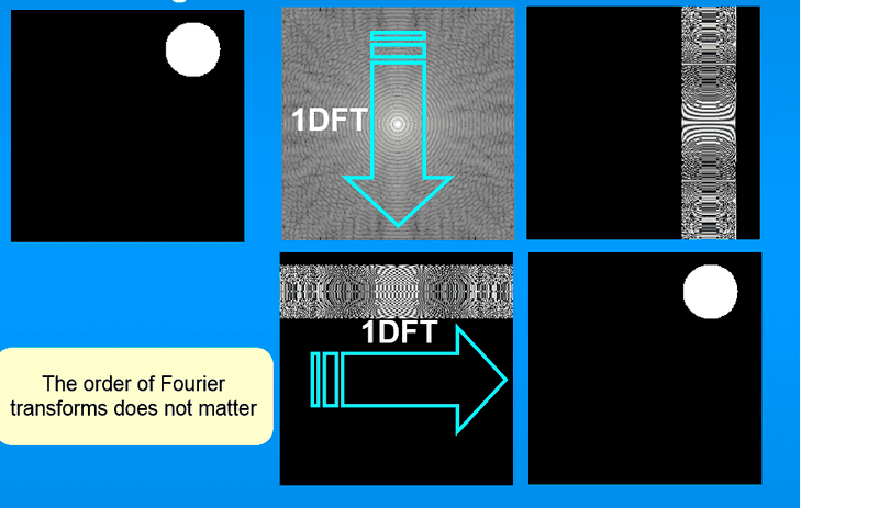

In this image the circle in the top left is the original. Next to it lies its K-space. We then see the result of running through k-space vertically and horizontally and then the combination of these two views.
I do not understand how the white circle can be reproduced. I though we would be adding pixel values in the two k-space data sets hence there should not be a black baground. This is obviously now what is happening. Please can someone explain how the two stripy images form the white circle. thanks

On this slide there is only one picture of k-space, the one on the top row, middle column. The picture on the top row right column and bottom row middle column are NOT pictures of k-space. They don't really have a name, but they would be called something like x*ky space and kx*y space. You would never add them together.

Absolutely. here is the link if anyone wants it
http://www.revisemri.com/tutorials/what_is_k_space/
What my question meant was how would you combine the "x*ky space and kx*y space" to produce the image? Thank you

You don't combine them.
So, the Fourier transform has the property that it is separable. In keeping with my above notation k-space is kx*ky space. If you Fourier transform in the X direction then you go from kx*ky space to x*ky space. If you then apply another Fourier transform, but in the y direction then you go from x*ky space to x*y space, which is the image.

OK so once we have decoded kx space --> x*ky space shouldn't we have a uniform signal at a particular x-value across the whole of y. My reasoning for this is that we know there is a y signal from ky but we don't know where it is. I don't understand why we see fancy patterns?

Are you familiar with the sinc function and how it Fourier transforms into a boxcar function?
If you go the other way it may be easier to understand. Start from the image domain and Fourier transform each row to go to the kx*y domain.
If the row is all zeros then it Fourier transforms to all zeros. Otherwise the row looks like a boxcar function so it Fourier transforms to a sinc function.
Different rows will have different boxcar widths and therefore different sinc functions. The "fancy pattern" is just all of those sinc functions put together.

Oh I see. So in any given row, the varying intensity on the figure displaying the kx*y domain arises because of the relative amplitude of the sinc function at the position in kx space?

Yes, relative amplitude and width.

Ah. thanks so much!
