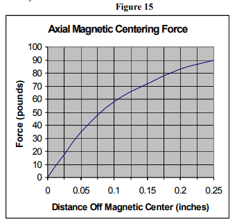

I need to find out how calculate magnetic forces appearing in AC induction motor rotor when it is not magnetically centered inside the stator.
I don't understand what that means. Can you make a picture and upload it here using the UPLOAD button?
These forces try to center the rotor inside the stator when the motor is started up. It is a problem in motors 500 kw and above and if they have journal bearings and lack of thrust bearings. Picture yourself a cut view of an AC induction motor. That is the only drawing needed.
I never before contemplated calculating that.
I guess i'd start with search for articles about it then search on terms in them to expand my vocabulary. Then i could phrase well stated questions.
http://www.baldorprospec.com/assets/pdf/motorprimer_part1.pdf
Brief discussion in section 12.
The magnetic centering force is a function of the magnetizing current of the motor (basically the no load amperage of the motor), air gap flux density, air gap radial distance, number of aligned rotor and stator segments (ends of rotor, and stator and radial air ducts), voltage, air gap axial length and axial misalignment between the rotor and stator. [22, 23] The magnetic centering force increases from zero when the motor is operating on its magnetic center (magnetic equilibrium), while the rotor is displaced axially relative to the stator. See Figure 15. Typically, at a 0.125” axial displacement, non-ducted rotors may develop 50 to 150 pounds of axial centering force, whereas rotors with 12 radial ventilating ducts aligned with stator duct may develop up to several hundred pounds. At start-up, these motors will develop axial forces up to three times these steady state values.

I searched the references in Jim Hardy article. Unfortunately the best one is very old and could not get it. Also, since the unbalance comes from the diferencial pressures in the cooling system of the motor (fan, ducts, etc.) the best way to measure is the way it is done in real operation: Measuring the displacement of the rotor at full speed (could be at no load)

The explanation of magnetic unbalance being caused by aerodynamic forces generated by cooling fans, makes a lot of sense. Then, in big motors, finding the magnetic unbalance seems to be only one way to find them: Testing. Running the motor at no load and measuring the displacement of the shaft at full speed, seems to be the only way to consider the magnetic unbalance. Have not find any theoretical way to calculate them, and if there is one, it is probably far too complex.
