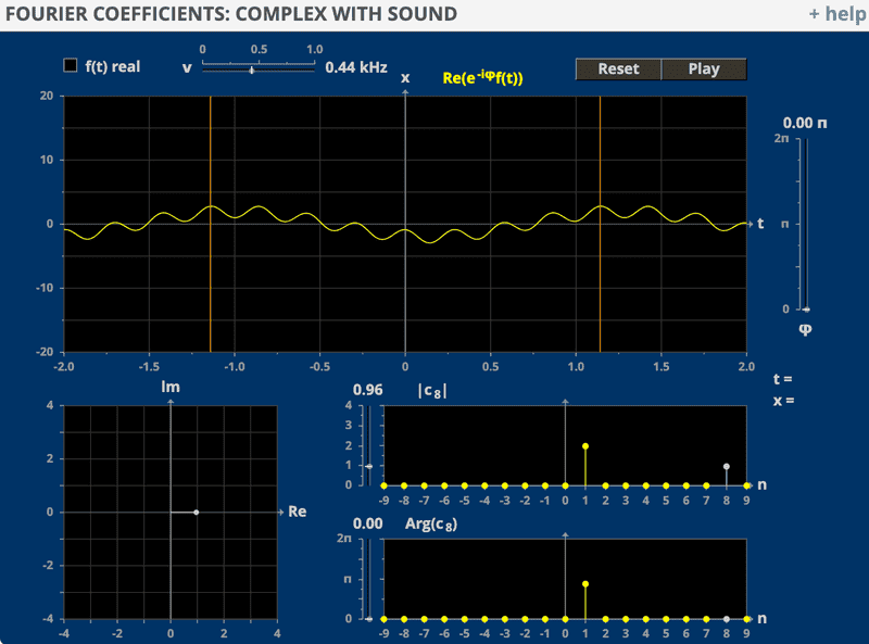

For example, suppose we choose ##\mathcal{v}=0.44\text{kHz}## and we are only taking the real part of (1) so that our sound becomes
$$2\cos{(440\pi t)}+\cos{(2\pi\cdot 440\cdot 8t)}$$
That is, we have a pure tone of 440Hz with coefficient ##c_1=2## and then we have coefficient ##c_8=1## which multiplies ##\cos{(16\cdot 440\pi t)}##.
If I understand correctly, both cosines have the same base frequency ##\mathcal{v}=440Hz##, but the cosine for ##c_8## has a much higher angular frequency. It is thus a "higher harmonic". The amplitude of the latter is ##c_8=1##.
How do we make it so that this higher harmonic has "much lower amplitude than the fundamental frequency"?
Here is the setup I have in the applet
By choosing a smaller value for ##c_8##, surely?

But what does it even mean to compare an amplitude to a frequency?
The smallest base frequency possible in the applet is 0.01kHz = 10 Hz.
The amplitude in the applet can go from 0 to 4.
Thus, in the applet the amplitude of any of the terms will always be smaller than the frequency. Yet, in the example I gave (where the frequency used is 440Hz and the amplitude is 1) we always hear two separate notes (something the notes say happens when the amplitude approaches the frequency).
It doesn’t. Where do you see that happening?
The ##c_n## values are the amplitudes of the pure tone constituent frequencies.
As integer values only?
Are you perhaps misinterpreting "If the higher harmonics have much lower amplitudes than the fundamental frequency"? It means "If the higher harmonics have much lower amplitudes than the fundamental frequency (has)". I.e. If the higher harmonics have much lower amplitudes than (the amplitude of) the fundamental frequency.
