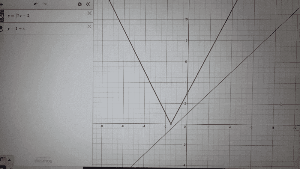

##|2x+3|-x=1##
i am getting ##x=-2## and ##x=\frac {-4}{3}## of which none satisfies the original equation, therefore we do not have a solution, right?
