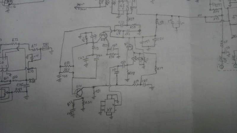

If you would, give me your email address. I will send you a picture of the board (w/o crystal) and schematic.

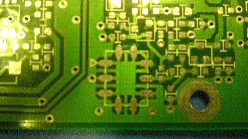

I just figured this out. New to this forum :-) Here are a couple of pics. One of the PCB crystal area and one of the schematic.

From your schematic, transistor B13 is a connection to Xf, the other being ground,
B13 has the base connected to ground and the one connecton of the CO connected to the collector and emitter of B13 through a capacitor. So all that does not make sense. You may want to do a retrace.

That would be Q13, not B13. One thing I saw missing on the schematic was pin 6 of the crystal going to gnd. The Q13 transistor C, B, E is drawn incorrectly, internally, however the actual traces are completely correct. You can verify that 9 of the 10 pins are connected to ground by simply looking at the picture of the board I posted. I know this isn't a typical crystal oscillator. I get how most of these function. This one I don't. I've had other EEs look at this and they just shake their heads. But they know it works somehow, obviously because I can read 200MHz on the freq. counter.

we don't really need to see the entire schematic BUT we DO need a real schematic of the area of the circuit concerned and not some hand drawn thing probably so it seems full of mistakes.
there's obviously problems with your schematic concerning Q13 and its connection to the XO or whatever it is

Okay, guys, I appreciate the help, but some of you are kind of rabid! This is the only schematic of this PCB, save the one locked up in Japan by the designer. And as I've said, the only thing not accurate about the schematic is the transistors weren't drawn to show the proper B, C, and E points - and pin 6 of the CO is grounded. Otherwise, it is accurate! You have no idea how many years and how much time I've spent on these units! I've repaired thousands of these, so please cut me some slack. If other EEs haven't been able to figure this out don't automatically assume I'm full of it. No other engineers who've looked at this unit have had a problem with the schematics, either. I'm just asking for help in figuring this stupid thing out.

What additional information do you seek that I haven't given? I've shown the entire circuit related to the CO and have described the thermal cycle. I attached a picture of the board where the crystal sits - where you can clearly see 9 pins are connected to each other and ground - yet for some reason nobody believes there's only one pin not connected to ground! My original post gave the CO part no. (200N1) but again, it was made specifically for this PCB and is long obsolete. No research is going to give you any more information about this exact CO or PCB. It's obvious this is not a typical oscillation circuit. But it does work - somehow. I think the real reason people are getting a bit testy is because they can't figure it out right away and it frustrates them - just like our EEs. That's not a slam against anyone, but I'm sure I'll get roasted for this observation... ;-)

This could be a SAW resonator. SAW means Surface Acoustic Wave so they are not the same as quartz crystals, but they operate at VHF and UHF frequencies which cannot easily be achieved directly with crystals
These are used in remote garage door and car door openers, usually in the range of 300 to 440 MHz.
There narrow spectrum allocations for the use of these short range devices and this varies according to the country.
The device on the board is not the oscillator, by itself, but it controls the frequency of the oscillator.
Digikey sell many different frequency SAW filters and resonators including some for 200 MHz.
http://media.digikey.com/pdf/Data Sheets/Panasonic Semiconductors ICs PDFs/EFO-H.pdf
although the frequency accuracy, in this case, is not very good. They can be up to 250 KHz off frequency.
