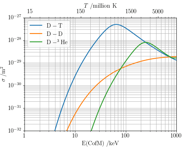

I'm working on programming a particle simulation that visually shows the nuclear fusion reaction rate of deuterium at different densities and temperatures, but I'm having trouble understanding exactly how nuclear fusion cross section diagrams are supposed to be interpreted. (The simulation assumes the particles are just deuterium atoms with one elementary positive charge each, and the only force acting on them is the coulomb repulsion force.)
Particularly, if I simulate (in 1D) one deuterium atom moving towards another stationary deuterium atom at 2 million meters per second (which corresponds to about 107 keV), the closest the atoms get during the collision before moving apart again is 65 femtometers.
According to the attached diagram, the fusion cross section at 107 keV is 8e-30 m^2, which I believe implies that if one deuterium atom gets within the radius of a sphere with this cross sectional area of the other deuterium atom, the atoms should fuse. However, an area of 8e-30 m^2 requires the atoms to get within 1.60 femtometers of one another, which is much closer than the coulomb repulsion allows the particles to get in my simulation. I am pretty confident in my math and numerical integration of the forces acting on the particles in my simulation so I doubt that they are at fault. How can the fusion cross section radius be smaller than the closest distance coulomb repulsion allows the particles to get during a collision?

You're given the total reaction cross section. The reactions per second per volume, ##f##, is then given by
##f = \frac{N^2}{2}\langle \sigma v\rangle##
where ##\langle \sigma v\rangle## is the thermal average of the particle speed, ##v##, times the cross section at that energy, ##\sigma##. ##N## is the particle number per volume.

I understand that tunneling is the major pathway by which fusion reactions occur but I assumed tunneling is factored into creating the fusion cross section diagrams.
Correct, but it is not considered in your simulation, that's why you get a difference.
If the protons approach each other to 70 fm then you have a small chance of fusion happening due to tunneling. The chance is small, but the impact parameter can be much larger than 2 fm. An integral would produce the cross section you have.
There is an additional effect you didn't consider yet: What you use is the average kinetic energy. The fusion probability increases rapidly with increasing energy. Fusion processes mainly happen in the tail of the kinetic energy distribution, where both deuterium nuclei have above average energy.
