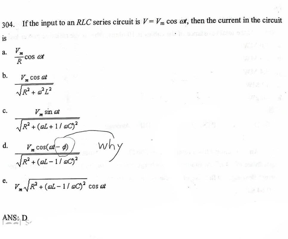

If the input to an RLC series circuit is V = Vm Cos ωt, then the current in the circuit is?
The answer is (D) as attached.
V = IZ
Z = [ R^2 + (XL - Xc)^2]^1/2
Why do we need to consider phase change?
Here are my thoughts: is it because voltages are different in phase for each of the three electrical accessories, R, L and C?

Because complex impedances will, in general, cause a phase shift between the voltage applied and the current. It's what they do. Suppose Z is just an inductor, would the current be in phase with the voltage?
No, the current will be lagged after voltage.
Which will appear as a phase shift between the voltage and current. That is why phase matters for complex impedance problems.
Thank you for your further explanation.
