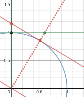

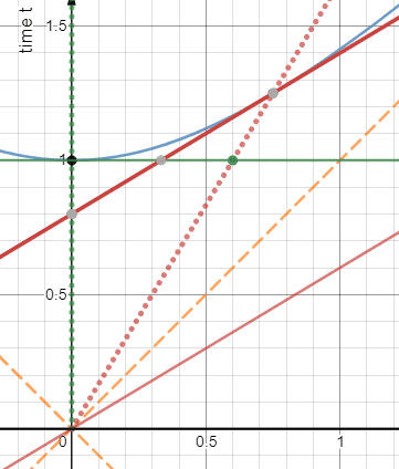

Check out https://www.desmos.com/calculator/r4eij6f9vw
For Euclidean, move the E-slider to -1
Minkowski discusses this on page 46 in https://www.minkowskiinstitute.org/mip/MinkowskiFreemiumMIP2012.pdf
So, he's making an analogy between a radius vector for a circle in Euclidean space and the tangent to the circle, and a radius vector to the surface c2tt - xx - yy - zz = 1 in Minkowski space and the tangent to the surface, and saying that the tangent is orthogonal to the radius, and he writes ..
"We decompose any vector, such as that from O to x; y; z; t into four
components x; y; z; t. If the directions of two vectors are, respectively, that
of a radius vector OR from O to one of the surfaces F = 1, and that of
a tangent RS at the point R on the same surface, the vectors are called
normal to each other. Accordingly,
c2tt1 􀀀 xx1 􀀀 yy1 􀀀 zz1 = 0"
It's the 'accordingly' in the above that I don't get ... he seems to think it is obvious ?
