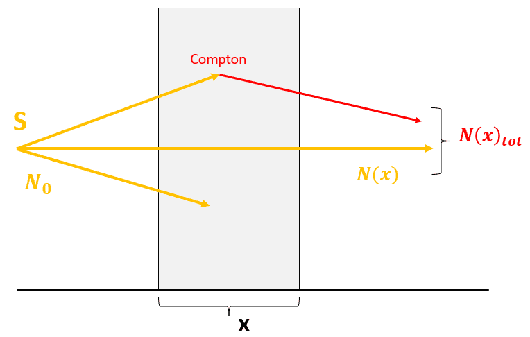

Consider a source emitting a beam of photons. These photons pass through x thickness of material. The attenuation coefficient of the beam \mu is known.
We can write this formula
If I'm not wrong, this formula tells us the number of photons that passed through the material of thickness x without interacting with it (
), but it does not tell us the "real" total number of photons that we should expect to see beyond this material (
) given by the sum of the first ones and the "scattered radiation".
My question is about what do we mean with "scattered radiation"?.
This is what I think about: "scattered radiation" are the photons resulting from the interaction of the primary beam with matter, that can happen in these ways:
1)photoelectric effect: with characteristic x-ray emission
2)Compton effect: in which the original photon loses energy, which is transferred to an electron
3)pair production: in which additional photons may be emitted if positron-electron annihilation occurs
4)coherent scattering: photon undergoes deflection but does not lose energy
Are these photons (1,2,3,4) the ones constituting the so-called "scattered radiation"? is there something else?P.S. To get a correct estimate of the photons passing through the material, thus also considering scattered photons, I should add a correction term, how is it estimated?

Yes I think so, as I've written, the number of photons that pass through the material without interacting should be given by this formula
That formula does not take into account "rescattering" becuase it is assumed that the in comming radiation is monoenergetic. Keep in mind that ##\mu## depends on the photon energy. For a more detailed treatment you need to perform simulations use e.g. Geant4 software
This follows from assuming that any "scattering" removes the particle from the incident beam, never to be seen again. This is often a good approximation for open geometries and collimated beams. Also it is very easy to apply.
Particles being returned to the beam after repeat scattering are rare although some devices (lasers for instance) rely on this effect , so you need to understand the system. These problems are typically much more difficult to calculate.
