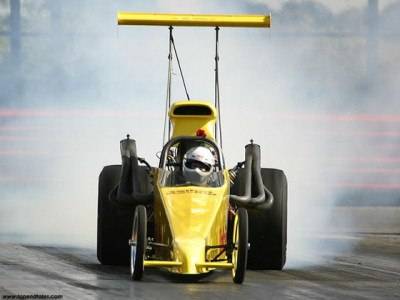

Low to the ground, front wheels for steering only, all the downforce directed to the back wheels by mechanical design and the wing. Designed for extreme speed. Lift is combated by design of the front body.
