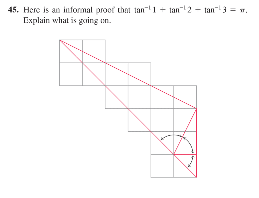

arctan(1)+arctan(2)+arctan(3)=Pi
I think tan(a)+tab(b)+tan(c)=tan(a)*tan(b)*tan(c)
So, I saw the answer but I couldn't understand it. But I think it can be solved by tan(a)+tab(b)+tan(c)=tan(a)*tan(b)*tan(c) (where a+b+c=Pi) , but I don't know how to transfer it to its inverse.
The answer:
242905

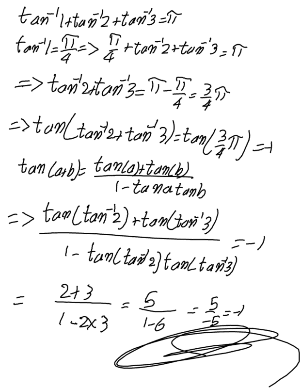

But: wouldn't it be easier to use some other equations, e.g. the expressions for ##\ \tan (a\pm b) ## ?
[/QUOTE]
Akshely(Sorry for my English, I don't know how to spell it correctly), yes! Thanks for your advice. for anyone interested for the proof:
242926

ali PMPAINT said:
solution book mentioned
On the lower right you see a triangle with a top left angle a that has tangent 1.
242925
On top of that angle is a triangle with a lower left angle b that has tangent 2.
And c has tangent 3.

BvU said:
I type ## \pi ## and get ##\pi##
that would be: actually
Oh! Now I got it! Thank you very much!
From the right triangles ABC, CBD, CDE, and AFE, the length of AE is the same as the length of AC + length of CE, so the line ACE is a straight line, the angle C is 180°.
