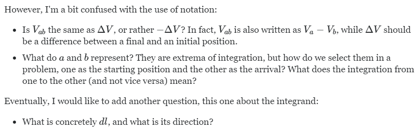

I ask some help in understanding better the concept of voltage. The voltage is a difference in electric potential between two points ##a## and ##b##. It is defined as
However, I'm a bit confused with the use of notation:
- Is ##V_{ab}## the same as ##\Delta{V}##, or rather ##-\Delta{V}##? In fact, ##V_{ab}## is also written as ##V_a-V_b##, while ##\Delta{V}## should be a difference between a final and an initial position.
- What do ##a## and ##b## represent? They are extrema of integration, but how do we select them in a problem, one as the starting position and the other as the arrival? What does the integration from one to the other (and not vice versa) mean?
Eventually, I would like to add another question, this one about the integrand:
- What is concretely ##dl##, and what is its direction?
Thanks very much!

This is only true for electrostatics, because only then the electric field has a potential, independent of the integration path in your formula, i.e., you can use any path connecting the points with the position vectors ##\vec{x}_a## and ##\vec{x}_b##. The potential is defined as
$$V(\vec{x})=-\int_{C(\vec{x}_0,\vec{x})} \mathrm{d} \vec{r} \cdot \vec{E}(\vec{r}),$$
where ##C(\vec{x}_0,\vec{x})## is an arbitrary curve connecting an arbitrary fixed point ##\vec{x}_0## with the variable point ##\vec{x}##. Then you have
$$\vec{E}(\vec{x})=-\vec{\nabla} V(\vec{x}).$$
The voltage is simply the difference of the potentials between the two points in question,
$$\Delta V=V(\vec{x}_b)-V(\vec{x}_a).$$
Since the line integral defining ##V## only depends on the initial an final points of the path, you get
$$\Delta V=-\int_{C'(\vec{x}_a,\vec{x}_b)} \mathrm{d} \vec{r} \cdot \vec{E}(\vec{r}),$$
where ##C'(\vec{x}_a,\vec{x}_b)## is an arbitrary path connecting the points at ##\vec{x}_a## and ##\vec{x}_b##.
Since you have responses about the other portions, I thought I would address this. If you have a typical voltmeter then A will be your red lead wire and B will be your black lead wire. So integrating from A to B or from B to A is just a matter of switching your lead wires.
