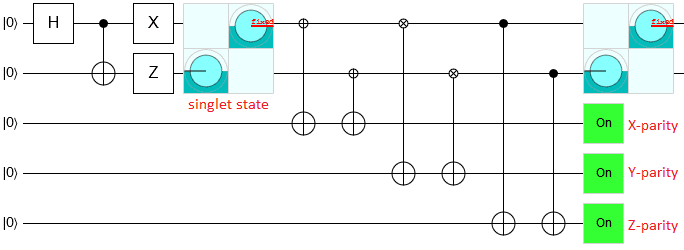

Maybe I understand these states better with the associated quantum circuit?
Is this how one would create the ##\left|T_0\right>## state?

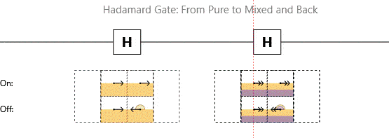

I try to imagine qubits as arrows, and I understand that a qubit can have a negative amplitude (but once squared, a positive probability).
However, how would I then picture the ##\left|S\right>## state?
Is this image relevant to the four states?
It comes from this explanation of Grover's Search Algorithm, and there are four states shown.
Is ##\left|01\right> + \left|10\right>##, ##\left|T_0\right>## the mixed state of the initially 'on' wire shown, and ##\left|01\right> - \left|10\right>##, ##\left|S\right>## the mixed state of the initially 'off' wire shown?

Those aren't the right states. The Bell basis is:
$$\begin{align}
B_{00} &= |00\rangle + |11\rangle \\
B_{10} &= |00\rangle - |11\rangle \\
B_{01} &= |01\rangle + |10\rangle \\
B_{11} &= |01\rangle - |10\rangle
\end{align}$$
(Edit: I don't mean that the video is wrong. They're talking about something slightly different. I'm saying you should care about the Bell basis for now, not the thing they are talking about.)
I'll call the Bell basis states "agree add", "agree subtract", "disagree add", and "disagree subtract" respectively. You can switch between these states by hitting either one of the involved entangled qubits with a Z gate (which switches the add/subtract bit) or with an X gate (which switches the agree/disagree bit).
These are all entangled states, but when you measure the involved qubits you will find that the specific state you're in affects whether the measurements along each axis will always agree or always disagree.
In the "disagree subtract" state, i.e. the singlet state, measurements give opposite answers along every axis.
In the "agree add" state, measurements along the X and Z axes will agree but measurements along the Y axis will disagree.
The other two states cause XY-agree/Z-disagree and YZ-agree/X-disagree respectively. Also you can create states where an X-axis measurement of one qubit will agree with a *Y*-axis measurement of the other (simply rotate one of the qubits 90 degrees). There's a whole spectrum of entangled states!
These kinds of details are important in quantum algorithms. For example, superdense coding puts information into the X and Z parities. If you don't know what the starting parities were, you won't be able to tell if the sender toggled them or not.
Oh hey, I wrote that post and made those images.
That animation is a representation of operations being applied to a single qubit. The bell basis states involve two qubits. So no, it's not directly relevant.
